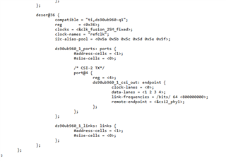

我们希望使用 Linux 为 max96724 + max96717 +相机开发驱动程序。 现在、我们需要为 max96724和 cdns_csi2rx0配置设备树。
&main_i2c1 {
    // MAX96724 Deserializer
    max96724: gmsl-deserializer@27 {
        status = "okay";
        compatible = "maxim,max96724";
        reg = <0x27>;
        #address-cells = <1>;
        #size-cells = <0>;
        enable-gpios = <&main_gpio0 32 GPIO_ACTIVE_HIGH>;
        i2c-alias-pool = <0x40 0x41 0x42 0x43>;
        i2c-atr {
            #size-cells = <0>;
        // Pipe configuration: bind Link A to Pipe 0
        pipe@0 {
            reg = <0>;
            maxim,link-id = <0>;    // Link A
            // If maxim,phy-id exists in the base DTS, leaving it out here removes it
        // Channel configuration: Channel 0 input from Pipe 0, output to PHY1 (corresponding to CSI Port B)
        channel@0 {
            reg = <0>;              // Channel index 0
            maxim,pipe-id = <0>;    // Data comes from Pipe 0
            maxim,phy-id = <1>;     // Place maxim,phy-id under the Channel node
            ports {
                #size-cells = <0>;
                // Output port connected to CSI2RX
                port@0 {
                    reg = <0>;
                    max96724_channelB_out: endpoint {
                        remote-endpoint = <&csi2rx0_in_sensor>;
                        bus-type = <4>;     // CSI2 D-PHY
                        clock-lanes = <0>;
                        data-lanes = <1 2 3 4>;
                // Input port
                port@1 {
                    reg = <1>;
                    endpoint { };
/* CSI Receiver Configuration */
&cdns_csi2rx0 {
    status = "okay";
    ports {
        #size-cells = <0>;
        csi0_port0: port@0 {
            reg = <0>;
            status = "okay";
            csi2rx0_in_sensor: endpoint {
                remote-endpoint = <&max96724_channelB_out>;
                bus-type = <4>; /* CSI2 DPHY */
                clock-lanes = <0>;
但根据日志,它似乎失败了。
[9.902459] max96724 1-0027:无法使用4504000.csi-bridge 创建设备链接(0x180)
[11.129724] cdns-csi2rx 4504000.csi-bridge:找不到 subdev max96724 1-0027的输出盘
如何修复它
