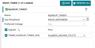

MCU_PLUS_SDK_VER=10_01_00_33
otp_keywriter_ver=09.01.00.05
SYSCFG_VER=1.20.0.00009 (Keywriter_User_Guide 根据 Make 错误从"AM62AX_OTP_OTP"中的版本1.15更新)
CCS_VERSION=12.2.0
错误信息:
➜  ti-arm-clang make -sj PROFILE=debug
Generating SysConfig files ...
Running script...
Error: cannot set 'instance' to 'WKUP_TIMER0': No option named WKUP_TIMER0 defined, valid options are
WKUP_TIMER1
    at setHelper (/root/ti/sysconfig_1.20.0/dist/webpack:/sysconfig/src/pinmux/services/objectManagers/proxyHandlers/managedObjectProxyHandler.ts:162:10)
    at Object.set (/root/ti/sysconfig_1.20.0/dist/webpack:/sysconfig/src/pinmux/services/objectManagers/proxyHandlers/managedObjectProxyHandler.ts:29:10)
    at scriptFunc (/root/ti/mcu_plus_sdk_am62ax_10_01_00_33/source/security/sbl_keywriter/am62ax-sk/r5fss0-0_nortos/example.syscfg:36:16)
    at cb (/root/ti/sysconfig_1.20.0/dist/webpack:/sysconfig/src/pinmux/services/scripting/runScript.ts:113:7)
    at withDeprecatedAccess (/root/ti/sysconfig_1.20.0/dist/webpack:/sysconfig/src/pinmux/services/deprecatedAccessGuard.ts:14:10)
    at runAsUserScript (/root/ti/sysconfig_1.20.0/dist/webpack:/sysconfig/src/pinmux/services/scripting/scriptingGuard.ts:61:3)
    at iteratee (/root/ti/sysconfig_1.20.0/dist/webpack:/sysconfig/src/pinmux/services/scripting/runScript.ts:111:5)
    at baseEach (/root/ti/sysconfig_1.20.0/dist/webpack:/sysconfig/node_modules/lodash/lodash.js:530:11)
    at Function.each (/root/ti/sysconfig_1.20.0/dist/webpack:/sysconfig/node_modules/lodash/lodash.js:9409:52)
    at /root/ti/sysconfig_1.20.0/dist/webpack:/sysconfig/src/pinmux/services/scripting/runScript.ts:109:6
make: *** [makefile:205: syscfg] Error 1
在 SysConfig GUI 中、这实际上不是 WKUP_TIMER0、
真的需要帮助
