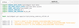

这是在 myinit.sh 中设置的。
#!/bin/sh
设置-x
导出路径=/usr/bin:/sbin:/bin
Export LD_LIBRARY_PATH=/lib:/usr/lib:$LD_LIBRARY_PATH
mount -t proc /proc
mount -n -t sysfs none /sys
mount -t debugfs none /sys/kernel/debug
mount -n -t tmpfs none /run
导出 SOC=am62a
导出 DEVICE_NAME=AM62A
#加载基本内核模块
insmod /lib/modules/6.6.44-ti-01478-g541c20281af7-dirty/kernel/drivers/rpmsg/rpmsg_char.ko
insmod /lib/modules/6.6.44-ti-01478-g541c20281af7-dirty/kernel/drivers/remoteproc/ti_k3_r5_remoteproc.ko
insmod /lib/modules/6.6.44-ti-01478-g541c20281af7-dirty/kernel/drivers/remoteproc/ti_k3_dsp_remoteproc.ko
echo am62a-mcu-r5f0_0-fw >/sys/kernel/debug/remoteproc/remoteproc0/firmware
Echo start >/sys/kernel/debug/remoteproc/remoteproc0/state
/sbin/udevd --daemon
/sbin/udevadm trigger --action=add
/sbin/udevadm 稳定
sysctl -w kernel.sem="500 32000 100 512"
Echo 500 >/proc/sys/kernel/sem
ulimit -c unlimited
回显"/tmp/core.%E.%p">/proc/sys/kernel/core_pattern
导出 EDGEAI_GST_APPS_PATH=/opt/edgeai-gst-apps
导出 EDGEAI_DATA_PATH=/opt/edgeai-test-data
导出 OOB_DEMO_Assets_path=/opt/oob-demo-assets
导出 model_zoo_path=/opt/model_zoo
导出 EDGEAI_VERSION=10.1
导出 EDGEAI_SDK_VERSION=10_01_00
Bash /opt/edgeai-gst-apps/scripts/setup_cameras_v3link.sh
media-ctl -V "imx219 6-0010":0 [fmt:SRGGB10_1x10/1920x1080 field:none]"
media-ctl -V '"cdns_csi2rx.30101000.csi-bridge":0 [fmt:SRGGB10_1x10/1920x1080 field:none]"
media-ctl -V '"30102000.ticsi2rx":0 [fmt:SRGGB10_1x10/1920x1080 field:none]"
Echo 1 >/sys/kernel/debug/remoteproc/remoteproc0/firmware
/opt/edgeai-gst-apps/apps_cpp/bin/Release/app_edgeai /opt/edgeai-gst-apps/configs/imx219_cam_example.yaml
ECHO "系统已初始化:Hello world!!!!! "

    您需要添加/bin/sh 以防止内核错误。
    init 脚本有一些问题。
    首先、我使用此 GST 命令进行测试:
    GST_DEBUG=2 gst-launch-1.0 -v v4l2src device=/dev/video-imx219-cam0 io-mode=dmabuf ! \
    video/x-bayer, width=1920, height=1080, framerate=30/1, format=rggb ! fakesink
    并且失败了
    Setting pipeline to PAUSED ... fakesink> video/x-bayer, width=1920, height=1080, framerate=30/1, format=rggb ! fakesink
    0:00:00.104544740   706     0x3b9af2d0 WARN                 default v4l2-utils.c:189:gst_v4l2_error:<v4l2src0> error: Cannot identify device '/dev.
    0:00:00.104607855   706     0x3b9af2d0 WARN                 default v4l2-utils.c:192:gst_v4l2_error:<v4l2src0> error: system error: No such file oy
    ERROR: from element /GstPipeline:pipeline0/GstV4l2Src:v4l2src0: Cannot identify device '/dev/video-imx219-cam0'.
    这是因为摄像机的 PIPLELINE 没有建立。 我运行此代码:
    /opt/edgeai-gst-apps/scripts/setup_cameras.sh
    我得到了以下日志:
    IMX219 Camera 0 detected
        device = /dev/video-imx219-cam0
        name = imx219
        format = [fmt:SRGGB8_1X8/1920x1080]
        subdev_id = /dev/v4l-imx219-subdev0
        isp_required = yes
    这意味着摄像机设备已正确映射。 然后、此行可运行:
    这只是 init 脚本发现的一个问题。 我需要更多时间进行调查。

    您好、Ke、
    我可以使用这个 myinit.sh 来显示摄像头
    #!/bin/sh
    set -x
    export PATH=/usr/bin:/sbin:/bin
    export LD_LIBRARY_PATH=/lib:/usr/lib:$LD_LIBRARY_PATH
    mount -t proc proc /proc
    mount -t tmpfs shm /dev/shm
    echo "tmpfs                /dev/shm             tmpfs      defaults      sdf s   0 0" >> /etc/fstab
    mkdir -p /dev/shm
    chmod 1777 /dev/shm
    mount -t tmpfs /dev/shm
    export SOC=am62a
    export DEVICE_NAME=AM62A
    # Load essential kernel modules
    insmod /lib/modules/6.6.58-ti-01497-ga7758da17c28-dirty/kernel/drivers/rpmsg/rpmsg_char.ko
    insmod /lib/modules/6.6.58-ti-01497-ga7758da17c28-dirty/kernel/drivers/rpmsg/rpmsg_ctrl.ko
    #insmod /lib/modules/6.6.58-ti-01497-ga7758da17c28-dirty/kernel/drivers/remoteproc/ti_k3_r5_remoteproc.ko
    #insmod /lib/modules/6.6.58-ti-01497-ga7758da17c28-dirty/kernel/drivers/remoteproc/ti_k3_dsp_remoteproc.ko
    # modprobe ti_k3_r5_remoteproc
    # modprobe ti_k3_dsp_remoteproc
    #sudo echo am62a-mcu-r5f0_0-fw > /sys/kernel/debug/remoteproc/remoteproc0/firmware
    #sudo echo start > /sys/kernel/debug/remoteproc/remoteproc0/state
    /sbin/udevadm settle
    #sysctl -w kernel.sem="500 32000 100 512"
    #echo 500 > /proc/sys/kernel/sem
    ulimit -c unlimited
    echo "/tmp/core.%e.%p" > /proc/sys/kernel/core_pattern
    export EDGEAI_GST_APPS_PATH=/opt/edgeai-gst-apps
    export EDGEAI_DATA_PATH=/opt/edgeai-test-data
    export OOB_DEMO_ASSETS_PATH=/opt/oob-demo-assets
    export MODEL_ZOO_PATH=/opt/model_zoo
    export EDGEAI_VERSION=10.1
    export EDGEAI_SDK_VERSION=10_01_00
    bash /opt/edgeai-gst-apps/scripts/setup_cameras.sh
    #sudo echo 1 > /sys/kernel/debug/remoteproc/remoteproc0/firmware
    ./opt/edgeai-gst-apps/apps_cpp/bin/Release/app_edgeai  ./opt/edgeai-gst-apps/configs/imx219_cam_example.yaml

    以下是我的文件。我是否正确执行此操作?
    e2e.ti.com/.../modifiedFile.zip
    Meng

    [00:00:07.000.000000]:error:[addGstPipeline:0256]源无效。
    [00:00:07.000.000135]:错误:[INITIALIZE:2246] addGstPipeline,()失败。
    /sbin/init:第63行:505分段故障(核心转储)/opt/edgeai-gl
    +回声'系统初始化:你好世界!!!!!!! '
    +/bin/sh
    SH:无法设置终端进程组(-1):设备的 ioctl 不适当
    SH:此 shell 中没有作业控制
    SH-5.2#
    Meng
    你(们)好
    修改 dtb 文件和解析后、 您需要重新编译 Linux 和 Linux dtb、然后重新生成 tispl.bin 文件。
