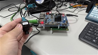

很抱歉再次打扰。 我们已经使用了 D3embedding 的相机 imx390-RCM
我们的配置:
SK-TDA4VM、DS90UB960Q1-EVM、D3Emmed imx390-RCM 摄像头。
但有一些问题,我们尝试使用,但它不起作用.
gst-launch-1.0 v4l2src device=/dev/video3 io-mode=dmabuf-import ! \
video/x-bayer, width=1936, height=1100, framerate=30/1, format=rggb12 ! queue leaky=2 ! \
tiovxisp sink_0::device=/dev/v4l-subdev10 sensor-name=SENSOR_SONY_IMX390_UB953_D3 \
dcc-isp-file=/opt/imaging/imx390/linear/dcc_viss.bin sink_0::dcc-2a-file=/opt/imaging/imx390/linear/dcc_2a.bin \
format-msb=11 ! tiovxldc dcc-file=/opt/imaging/imx390/linear/dcc_ldc.bin sensor-name=SENSOR_SONY_IMX390_UB953_D3 \
sink_0::pool-size=8 c::pool-size=8 ! video/x-raw, format=NV12, width=1920, height=1080, framerate=30/1 ! \
kmssink sync=false driver-name=tidss

我们还确认驾驶员工作正常。
root@tda4vm-sk:/opt/edgeai-gst-apps # dmesg | grep IMX
[ 12.395491] imx390 10-001A:插入频率:27027027 Hz
[12.478748] imx390 10-001A:探测 imx390
root@tda4vm-sk:/opt/edgeai-gst-apps # dmesg | grep DS9
[10.518185] ds90ub960 6-003d:未找到电源 VDDIO、使用虚拟调节器
[ 10.735575] ds90ub960 6-003d:固定依赖周期、带/bus@10000/i2c@2030000/i2c-mux@70/i2c@0/deser@3D/links/link@0/串行器
[ 12.134227] ds90ub953 6-0044:找到 ub953 rev/mask 0x20
[ 12.157149] ds90ub953 6-0044:固定依赖周期、/bus@10000/i2c@2030000/i2c-mux@70/i2c@0/deser@3D/links/link@0/serial/i2c/sensor@1a

    这是我们的错误消息
    root@tda4vm-sk:/opt/edgeai-gst-apps# gst-launch-1.0 v4l2src device=/dev/video3 io-mode=dmabuf-import ! \
    > video/x-bayer, width=1936, height=1100, framerate=30/1, format=rggb12 ! fakesink
    Setting pipeline to PAUSED ...
    Pipeline is live and does not need PREROLL ...
    Pipeline is PREROLLED ...
    Setting pipeline to PLAYING ...
    New clock: GstSystemClock
    ERROR: from element /GstPipeline:pipeline0/GstV4l2Src:v4l2src0: No downstream pool to import from.
    Additional debug info:
    /usr/src/debug/gstreamer1.0-plugins-good/1.22.12/sys/v4l2/gstv4l2object.c(5471): gst_v4l2_object_decide_allocation (): /GstPipeline:pipel:
    When importing DMABUF or USERPTR, we need a pool to import from

    它正常工作、并探测正常、但如果我转储 0x44 和 0x3D、它会告诉我“错误:无法将地址设置为 0x3D:器件或资源繁忙“
    我们的硬件安装方法如图所示
    Kathy
    尊敬的 Kathy:
    "错误“错误:无法将地址设置为 0x3D:设备或资源繁忙“
    这些日志应该没有问题。 这仅意味着 Linux 内核可以控制这些 I2C 地址、这意味着解串器已初始化。 除了日志之外、似乎 从 Linux 内核的角度而言、摄像头和解串器都已正确配置。
    因此、不同的想法是、配置摄像头时可能缺少一些步骤?
    我建议浏览此常见问题解答: https://e2e.ti.com/support/processors-group/processors/f/processors-forum/1403218/faq-what-are-the-common-reasons-v4l2-based-applications-fail-to-capture-images-from-a-probed-csi-sensor
    上述常见问题解答也适用于 SK-TDA4VM。 可能是 media-ctl 命令需要手动运行。 常见问题解答中还有其他一些疑难解答信息、因此我认为很适合介绍一下。
    Takuma
    尊敬的 Takuma:
    我真的很抱歉打扰你这么多。 我们尝试检查这里的每个节点以进行确认、还更改了视频节点。 使用所有视频节点的结果仍然相同、因此我假设需要检查硬件配置。 我是否需要了解有关 ds90ub960q1-EVM 硬件配置的任何信息?
    Kathy
    尊敬的 Kathy:
    是否可以共享“media-ctl -p“中的日志、以便我也可以重复检查以防万一?
    至于硬件、是否需要为正在使用的解串器电路板提供外部电源? 我知道有多个版本的解串器电路板、它们需要外部电源上电、本常见问题解答中介绍了一个上电顺序: https://e2e.ti.com/support/processors-group/processors/f/processors-forum/1452909/faq-am67a-enabling-csi2-sensors-via-fusion-board-on-am6x
    我在上面的常见问题解答中使用了名为“Fusion 1 子板“的电路板、我的理解是、如果解串器板未先通电、可能会导致 I2C 地址发生变化。 这是因为 I2C 地址取决于解串器板上其中一个引脚的电压电平、首先为 SK 板上电会导致 SK 板错误地看到解串器板的 I2C 地址为非预期值。 由于您可以在正确的位置看到 I2C 地址、因此我怀疑是否发生了这种情况、但无论如何、最好检查是否需要外部电源。
    Takuma

    我们有一个过程是首先启动融合板、然后启动 sk-tda4vm。
    但问题仍然存在(使用 v4l2-ctl -D3 --set-fmt-video=width=1936、height=1100、pixelformat=RG12 --stream-mmap 没有数据流)
    根据我的理解、i2c 设置可能存在一些小问题。 UB960 通道是否可能设置不正确? 除了 0x4C 设置外、是否还需要更改其他寄存器位置?

    感谢您的日志。 和预期的一样。 到目前为止、似乎没有什么特别的。 到目前为止、我们所看到的一切都看起来很好、摄像头应该能正常工作。
    我目前想问一些人、 是否可以  在本地获取 DS90UB960Q1-EVM、以便复制您的确切硬件设置。 到目前为止、我找不到该精确的板。 不过、也有很多具有 DS90UB960 的不同电路板、比如我在上一篇回复中使用的 Arducam 的“微型融合“电路板。 因此,可能需要一两周的时间来订购和获得相同的董事会。
    同时、在 v4l2-ctl 和 gstreamer 实验中指定器件时、您是否可以尝试使用符号链接/dev/video-imx390-cam0 而不是视频编号? 看起来您在 v4l2-ctl 的最新日志中使用了正确的设备编号、但最好进行检查、以防万一、因为视频设备编号的更改是我们在设置符号链接之前遇到的常见问题。
    Takuma
