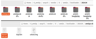

我的客户在执行下面的脚本时遇到了以下日志和错误消息。
未生成新的 U-Boot — 请告知。

Changes not staged for commit:
  (use "git add <file>..." to update what will be committed)
  (use "git restore <file>..." to discard changes in working directory)
modified:   scripts/dtc/pylibfdt/libfdt.i_shipped   ==> 이 부분은 제가 patch를 했습니다

no changes added to commit (use "git add" and/or "git commit -a")
ERROR: Local changes detected in: u-boot

    您好、Jack、
    您是否错过了提供运行脚本的命令?
