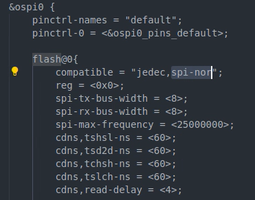

    OSPI 控制节点如下:
    aliases {
    		serial0 = &mcu_uart0;
    		serial1 = &wkup_uart0;
    		serial2 = &main_uart0;
    		mmc0 = &sdhci0;
    		mmc1 = &sdhci1;
    		ethernet0 = &cpsw_port1;
    		spi0 = &ospi0;
    &ospi0 {
    	pinctrl-names = "default";
    	pinctrl-0 = <&ospi0_pins_default>;
    	flash@0{
    		compatible = "jedec,spi-nor";
    		reg = <0x0>;
    		spi-tx-bus-width = <8>;
    		spi-rx-bus-width = <8>;
    		spi-max-frequency = <25000000>;
    		cdns,tshsl-ns = <60>;
    		cdns,tsd2d-ns = <60>;
    		cdns,tchsh-ns = <60>;
    		cdns,tslch-ns = <60>;
    		cdns,read-delay = <4>;
    		partitions {
    			compatible = "fixed-partitions";
    			#address-cells = <1>;
    			#size-cells = <1>;
    			partition@0 {
    				label = "ospi.tiboot3";
    				reg = <0x00 0x37c0000>;
    			partition@3fc0000 {
    				label = "ospi.phypattern";
    				reg = <0x3fc0000 0x40000>;
    可以修改(修补)内核驱动程序、但不能修改 U-boot。 当前项目已删除并进入 U-Boot 阶段。 稍后很难验证。
