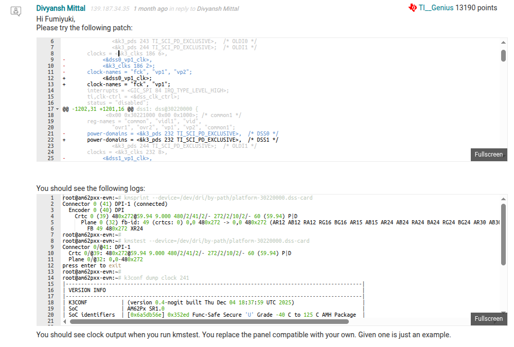

    您好 Shanooj:
    请使用以下补丁代替上述补丁。 无需修改驱动程序:
    diff --git a/arch/arm64/boot/dts/ti/k3-am62p5-sk.dts b/arch/arm64/boot/dts/ti/k3-am62p5-sk.dts
    index 740c25d92..9ac0313b2 100644
    --- a/arch/arm64/boot/dts/ti/k3-am62p5-sk.dts
    +++ b/arch/arm64/boot/dts/ti/k3-am62p5-sk.dts
    @@ -43,8 +43,7 @@ framebuffer0: framebuffer@0 {
     			compatible = "simple-framebuffer";
     			power-domains = <&k3_pds 186 TI_SCI_PD_EXCLUSIVE>;
     			clocks = <&k3_clks 186 6>,
    -				 <&dss0_vp1_clk>,
    -				 <&k3_clks 186 2>;
    +				 <&dss0_vp1_clk>;
     			display = <&dss0>;
     			status = "disabled";
    @@ -594,7 +593,7 @@ port@0 {
     				reg = <0>;
     				sii9022_in: endpoint {
    -					remote-endpoint = <&dss0_dpi1_out>;
    +					remote-endpoint = <&dss1_dpi0_out>;
    @@ -884,16 +883,32 @@ &dss_oldi_io_ctrl {
     &dss0 {
     	bootph-all;
     	status = "okay";
    +&dss1 {
    +	status = "okay";
     	pinctrl-names = "default";
     	pinctrl-0 = <&main_dpi_pins_default>;
    +	clocks = <&k3_clks 232 8>,
    +		 <&k3_clks 232 0>,
    +		 <&k3_clks 232 4>;
    +	assigned-clocks = <&k3_clks 241 0>,	/* DSS1-VP0 */
    +			  <&k3_clks 240 0>,	/* DSS1-VP1 */
    +			  <&k3_clks 245 0>;	/* DPI Output */
    +	assigned-clock-parents = <&k3_clks 241 2>,	/* PLL 17 HDMI */
    +				 <&k3_clks 240 1>,	/* PLL 18 DSI */
    +				 <&k3_clks 245 2>;	/* DSS1-DPI0 */
    -&dss0_ports {
    -	/* DSS0-VP2: DPI/HDMI Output */
    -	hdmi0_dss: port@1 {
    -		reg = <1>;
    +&dss1_ports {
    +	/* DSS1-VP0: DPI/HDMI Output */
    +	port@0 {
    +		reg = <0>;
    -		dss0_dpi1_out: endpoint {
    +		dss1_dpi0_out: endpoint {
     			remote-endpoint = <&sii9022_in>;

    您好 Shanooj:
    我能够复制错误。 该补丁不支持显示共享用例、但在启用显示共享时失败。 正在努力解决这个问题。
    您好 Shanooj:
    请尝试此补丁。 在我结束时测试:
    index 740c25d92..cb15bbb8e 100644
    -				 <&dss0_vp1_clk>,
    -				 <&k3_clks 186 2>;
    +				 <&dss0_vp1_clk>;
     			display = <&dss0>;
     				reg = <0>;
    @@ -884,16 +883,43 @@ &dss_oldi_io_ctrl {
     &dss0 {
     	bootph-all;
     	status = "okay";
    +&dss1 {
    +	status = "okay";
    +	 * Only DSS1's own PD (232) is needed here. Drop OLDI1 (PD 244) from
    +	 * the base DTSI list: that PD is physically a DSS0 resource held by
    +	 * the R5 display-share firmware for dual-LVDS. DSS1 is DPI-only so
    +	 * OLDI1 is unused, and its presence causes pm_runtime_get_sync() to
    +	 * fail (refcount=0, TI SCI rejects the first Linux power-on request
    +	 * while R5 holds the domain) → device_link_add() returns NULL → -EINVAL.
    +	 * Without shared mode DSS0 activates PD 244 first so DSS1 never
    +	 * triggers the TI SCI call itself, masking the problem.
    +	power-domains = <&k3_pds 232 TI_SCI_PD_EXCLUSIVE>;
    +		 <&k3_clks 232 0>,
    +		 <&k3_clks 232 4>;
    -&dss0_ports {
    -		reg = <1>;
    +&dss1_ports {
    +	port@0 {
    +		reg = <0>;
