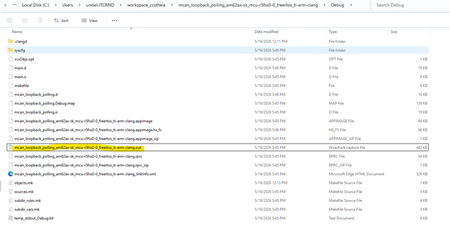

    3) 内置到 SD 卡/root/lib/firmware/am62a-mcu-r5f0_0-fw 后、按如下所示复制了.out 文件

    3) 在内置到 SD 卡/root/lib/firmware/am62a-mcu-r5f0_0-fw 后、按如下所示复制了.out 文件:
    需要将其复制到此路径: /lib/firmware/pdk-ipc/am62a-mcu-r5f0_0-fw
    请参阅以下文档:https://software-dl.ti.com/processor-sdk-linux/esd/AM62AX/11_01_07_05/exports/docs/linux/Foundational_Components_ ipc62ax.html#Getting started-with-ipc-linux-examples

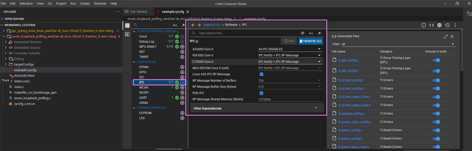

    1) 我在 CCS 工具中完成了 MCAN 环回轮询 FreeRTOS 示例中的 IPC 配置、如下所示

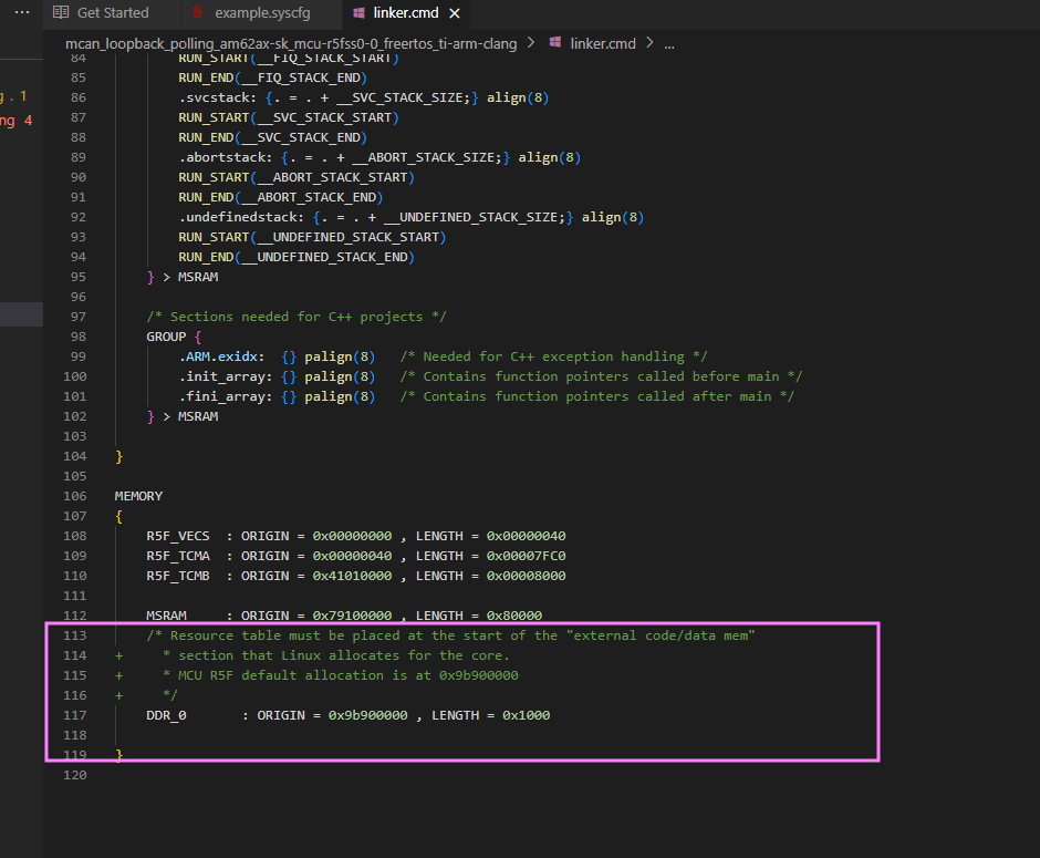

    2) 根据 您的链接中提到的、我更新了链接器命令、如下所示
    3) 配置和更新链接器文件后、在编译 I ma 时收到以下错误
    诚邀您进行检查、敬请告知我们如何继续进行 CAN 通信。

    您好、
    您是否可以在 linker.cmd 上使用以下补丁并检查它是否有效:
    diff --git a/examples/drivers/mcan/mcan_loopback_polling/am62ax-sk/mcu-r5fss0-0_nortos/ti-arm-clang/linker.cmd b/examples/drivers/mcan/mcan_loop
    index cbf2fe4b..41ba61a4 100644
    --- a/examples/drivers/mcan/mcan_loopback_polling/am62ax-sk/mcu-r5fss0-0_nortos/ti-arm-clang/linker.cmd
    +++ b/examples/drivers/mcan/mcan_loopback_polling/am62ax-sk/mcu-r5fss0-0_nortos/ti-arm-clang/linker.cmd
    @@ -55,6 +55,15 @@ SECTIONS
             .rodata: {} palign(8)   /* This is where const's go */
         } > MSRAM
    +    /* this is used only when IPC RPMessage is enabled, else this is not used */
    +    .bss.ipc_vring_mem   (NOLOAD) : {} > DDR_IPC_VRING_RTOS
    +    GROUP {
    +        /* This is the resource table used by linux to know where the IPC "VRINGs" are located */
    +        .resource_table: {} palign(1024)
    +    } > DDR_IPC_RESOURCE_TABLE_LINUX
    +    /* This IPC log can be viewed via ROV in CCS and when linux is enabled, this log can also be viewed via linux debugfs */
    +    .bss.debug_mem_trace_buf    : {} palign(128)    > DDR_IPC_TRACE_LINUX
         /* This is rest of initialized data. This can be placed in DDR if DDR is available and needed */
         GROUP {
             .data:   {} palign(8)   /* This is where initialized globals and static go */
    @@ -105,4 +114,13 @@ MEMORY
         MSRAM     : ORIGIN = 0x79100000 , LENGTH = 0x80000
    +    DDR_IPC_RESOURCE_TABLE_LINUX     : ORIGIN = 0x9B900000 LENGTH = 0x400      /* For resource table   */
    +    DDR_CODE_DATA                    : ORIGIN = 0x9BA00000 LENGTH = 0xE00000   /* For code and data    */
    +    DDR_IPC_TRACE_LINUX              : ORIGIN = 0x9B900400 LENGTH = 0xFFC00    /* IPC trace buffer     */
    +     3MB from address 0XA0000000 is used by RTOS IPC on Vision apps.
    +     As the C7x binary is taken from vision apps, C7x will be writing to this memory.
    +     So, for MCU+SDK we are using memory which is not used by Vision apps RTOS IPC.
    +    DDR_IPC_VRING_RTOS               : ORIGIN = 0xA0400000, LENGTH = 0x300000   /* IPC VRING for RTOS/NoRTOS */
    你好 认识 Thakar ,
    感谢您的答复!
    我修改了 linker.cmd 文件、UART 工作正常并记录了日志、如下所示:
