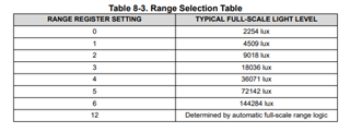

    此外、还可以通过读取每个通道输出寄存器的 EXPONENT 位来确定要测量的范围:
    这些位的值根据下表确定传感器当前正在测量的以下测量范围中的哪一个:
    Daniel

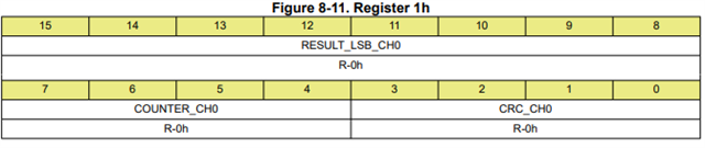

    是的、我很抱歉、我发现我在随后的代码片段中错误地对结果数据应用了一个掩码。 我在下面附上了转换函
            # Extract register address and bit range
            address = reg_info['address']
            bits = reg_info['bits']
            # Read the two bytes from the register (case of reading color data)
            if isinstance(address, tuple):
                # Read 2 bytes from 0x00 (MSB)
                msb_data = self.i2c.readfrom_mem(self.device_address, 0x00, 2)
                result_exponent = (int.from_bytes(msb_data, 'big') >> 12) & 0x0F  # Extract bits 15-12
                result_msb = int.from_bytes(msb_data, 'big') & 0x0FFF  # Mask to keep bits 11-0
                # Read 1 byte from 0x01 (LSB)
                result_lsb = self.i2c.readfrom_mem(self.device_address, 0x01, 1)[0]  # Read bits 15-8
                # Combine into a 20-bit value
                mantissa = (result_msb << 8) | result_lsb  # Shift MSB left by 8 and OR with LSB
                # Exctract adc codes
                data = (mantissa<<result_exponent)
    虽然这现在产生了更加一致的关系、但它仍然不像您预期的那样是线性的。 我在下面附上了最新的图表
    再次感谢、
    REGAN
