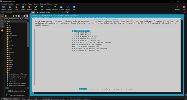

    CONFIG_BT_HCIBTSDIO 被禁用、CONFIG_BT_TI 和 CONFIG_BT_TI_SDIO 均被启用、如下所示:
    # Bluetooth device drivers
    # CONFIG_BT_HCIBTUSB is not set
    # CONFIG_BT_HCIBTSDIO is not set
    # CONFIG_BT_HCIUART is not set
    # CONFIG_BT_HCIBCM203X is not set
    # CONFIG_BT_HCIBPA10X is not set
    # CONFIG_BT_HCIBFUSB is not set
    # CONFIG_BT_HCIVHCI is not set
    CONFIG_BT_TI=m
    CONFIG_BT_TI_SDIO=m
    # CONFIG_BT_MRVL is not set
    # CONFIG_BT_MTKSDIO is not set
    # end of Bluetooth device drivers
    Dylan
    然后你没有正确构建它,因为你的 lsmod 输出显示 btsdio 仍然存在。
