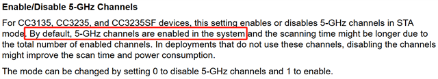

    感谢您的建议。
    我没有修改网络终端 演示。
     SimpleLink  Wi-FiRegisteredCC3x20、CC3x3x 网络处理器用户指南指出5G 通道默认处于启用状态。
    对于演示"自述文件"、setpolicy 命令建议默认情况下为所有通道启用5G 通道扫描。
    Usage:
      setpolicy [-help] [-i <Scan interval in Sec>] [-h <hidden scan>]
                [-c <Channel Mask in HEX>] [-r <RSSI threshold>] [-o <Turn scans off>]
      -i      Sets scan interval in seconds (default is 10 seconds)
      -h      Scan for hidden AP as well (hidden scan = [YES, NO], default is NO)
      -c      Sets specific scan channels for 2.4Ghz, using HEX base bitmask. (default is `0x1FFF` - all enabled)
      -d      Sets specific scan channels for 5Ghz, using HEX base bitmask (if bit i is set, scan for the channel at index i according to 5Ghz channels bits order which the device support. E.g 36->0001, 40->0010, 44->0100.. etc). (default is `1F7FFFF` - all enabled)
      -r      Sets RSSI threshold for scan in dBm units (range: [-95,0] default: `-95`)
      -o      Turn scans off (YES = scans running in background would stop immediately)
      -help   Show Help regarding the setpolicy command.
    顺便说一下、它可以扫描其他5G WiFi。 我认为扫描配置设置正确。
