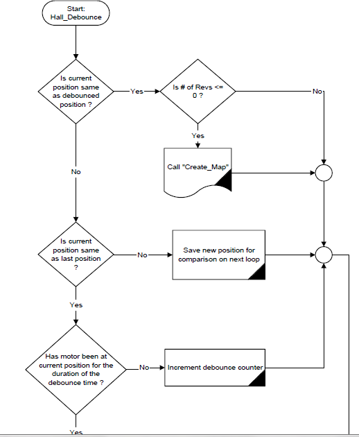

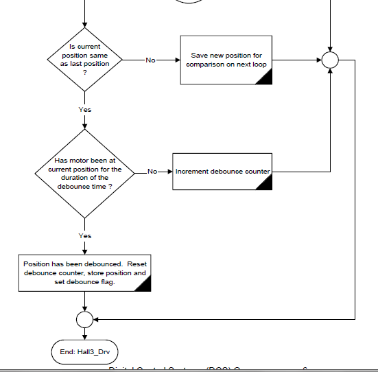

            我还能过分点在向您请教一个问题吗?就是关于无刷直流机转子位置传感器例程程序中  Debounce的问题,其流程图如下:
    hall3_drv.pdf

          您好!感谢您的回复。问题是这样的,在debounce程序中 Stallcount 是什么啊,为什么计数这么多次呢? 非常感谢您的回复程序附录如下:
    void F281X_EV1_HALL3_Debounce(HALL3 *p)
    if (p->HallGpio == p->HallGpioAccepted) // GPIO_UNCHANGED: 没变Current GPIO reading == debounced GPIO reading?
    if (p->Revolutions <= 0) // Only create hall map during initial Revolutions
    F281X_EV1_HALL3_Create_Map(p);
    p->StallCount -= 1; // Decrement stall counter
    if (p->StallCount == 0)
    p->EdgeDebounced = 0x7FFF; // If motor has stalled, then user trigger to commutate
    p->StallCount = 0xFFFF; // Reset counter to starting value
    else // GPIO_CHANGED: If not zero, then the motor has moved to a new position.
    if (p->HallGpio == p->HallGpioBuffer) // Current GPIO reading == previous GPIO reading?
    if (p->DebounceCount >= p->DebounceAmount) // If equal, is current GPIO reading debounced?
    p->HallGpioAccepted = p->HallGpioBuffer; // Current GPIO reading is now debounced,当前位置已经去抖
    p->EdgeDebounced = 0x7FFF; // Edge/position debounced, trigger commutation
    p->DebounceCount = 0; // Reset debounce counter
    if (p->HallMapPointer==0)
    p->Revolutions += 1; // Increment on every rev (HallMapPointer = 0)
    else // DEBOUNCE_MORE
    p->DebounceCount += 1; // Increment debounce counter
    else // NEW_READING
    p->HallGpioBuffer = p->HallGpio; // Save new reading and reset debounce counter
