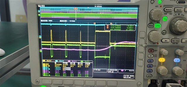

TMS320F28377D: ePWM 使用上升下降模式 进行调制时出现异常驱动
Part Number: TMS320F28377D
ePWM 使用上升下降模式 进行调制时出现异常驱动;
在PWM封波后发出一个周期长脉冲
控制代码:
if( mInvtCtl.Pwmap < mInvtCtl.MinPwm) { L1H.CMPA.bit.CMPA = 0; L1H.AQCSFRC.all = 0b0101;}
else if(mInvtCtl.Pwmap > mInvtCtl.MaxPwm){ L1H.CMPA.bit.CMPA = EPwm1Regs.TBPRD; L1H.AQCSFRC.all = 0b1010;}
else { L1H.CMPA.bit.CMPA = mInvtCtl.Pwmap; L1H.AQCSFRC.all = 0; }
if( mInvtCtl.Pwman < mInvtCtl.MinPwm) { L1L.CMPA.bit.CMPA = 0; L1L.AQCSFRC.all = 0b0101;}
else if(mInvtCtl.Pwman > mInvtCtl.MaxPwm){ L1L.CMPA.bit.CMPA = EPwm1Regs.TBPRD; L1L.AQCSFRC.all = 0b1010;}
else { L1L.CMPA.bit.CMPA = mInvtCtl.Pwman; L1L.AQCSFRC.all = 0; }

  • 你好,
