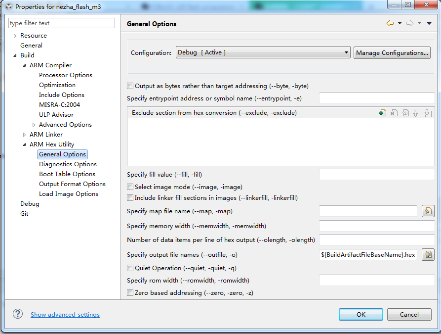

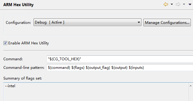

我在CCS6.1 中如下面图选址了输出hex,输出格式选择是Intel格式, 但是输出的HEX文件内容不对, 用工具转成bin文件也转不出来。
另外:后缀 .i1, .i2 , .i3是什么文件? .b10, i01, i10, i11又是什么文件?
配置如下:
配置如下:
如果你要生成bin格式的话,点击build, 选择
bin generate:
post step : "${CCE_INSTALL_ROOT}/utils/tiobj2bin/tiobj2bin" "${BuildArtifactFileName}" "${BuildArtifactFileBaseName}.bin" "${CG_TOOL_ROOT}/bin/armofd" "${CG_TOOL_ROOT}/bin/armhex" "${CCE_INSTALL_ROOT}/utils/tiobj2bin/mkhex4bin"
Eric
这个设置M3的可以转换,C28不能转换:
"C:/ti/ccsv6/utils/tiobj2bin/tiobj2bin" "flash_programming_c28.out" "flash_programming_c28.bin" "C:/ti/ccsv6/tools/compiler/ti-cgt-c2000_6.4.6/bin/armofd" "C:/ti/ccsv6/tools/compiler/ti-cgt-c2000_6.4.6/bin/armhex" "C:/ti/ccsv6/utils/tiobj2bin/mkhex4bin"
tiobj2bin.bat failed on "C:/ti/ccsv6/tools/compiler/ti-cgt-c2000_6.4.6/bin/armofd"
Please see http://processors.wiki.ti.com/index.php/Tiobj2bin_Failed
tiobj2bin.bat failed on "C:/ti/ccsv6/tools/compiler/ti-cgt-c2000_6.4.6/bin/armhex"
'C:\ti\ccsv6\tools\compiler\ti-cgt-c2000_6.4.6\bin\ofd470' 不是内部或外部命令,也不是可运行的程序
或批处理文件。
File does not exist: at XML_TI_OFD.pm line 877.
"C:/ti/ccsv6/utils/tiobj2bin/mkhex4bin" failure occurred. Giving up.
