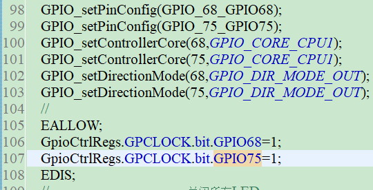

1.为 GPIO68和 GPIO75配置引脚多路复用
GPIO_setPinConfig (GPIO_68_GPIO68);
GPIO_setPinConfig (GPIO_75_GPIO75);
2.选择 GPIO 引脚的控制器内核
GPIO_setControllerCore (68、GPIO_CORE_CPU1);
GPIO_setControllerCore (75、GPIO_CORE_CPU1);
3.设置引脚的方向
GPIO_setDirectionMode (68、GPIO_DIR_MODE_OUT);
GPIO_setDirectionMode (75、GPIO_DIR_MODE_OUT);
4.切换 GPIO 引脚
GPIO_togglePin (68);
GPIO_togglePin (75);

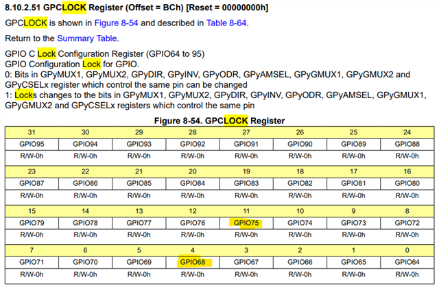

顺便说一下、您还需要配置锁定寄存器:
