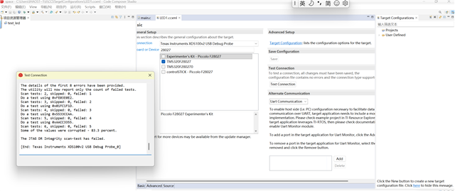

TMS320F28027F:CCS (Code Composer Studio) 在尝试用XDS100v2 仿真器驱动加载成功但连接时失败怎么解决
Part Number: TMS320F28027F
开发板正常连接后,但与我的ccs12.4.0 连接不上尝试了很多方法,但无法解决,请问大佬们,有何见解

  • 我通过配置时钟,现在报错是“”即“
    • IR path-length failed → s
      [Start: Texas Instruments XDS100v2 USB Debug Probe_0]
      Execute the command:
      %ccs_base%/common/uscif/dbgjtag -f %boarddatafile% -rv -o -F inform,logfile=yes -S pathlength -S integrity
      [Result]
      -----[Print the board config pathname(s)]------------------------------------
      C:\Users\IHAOST~1\AppData\Local\TEXASI~1\
      CCS\ccs1240\0\0\BrdDat\testBoard.dat
      -----[Print the reset-command software log-file]-----------------------------
      This utility has selected a 100/110/510 class product.
      This utility will load the adapter 'jioserdesusb.dll'.
      The library build date was 'Jun 2 2023'.
      The library build time was '12:47:07'.
      The library package version is '9.12.0.00150'.
      The library component version is '35.35.0.0'.
      The controller does not use a programmable FPGA.
      The controller has a version number of '4' (0x00000004).
      The controller has an insertion length of '0' (0x00000000).
      This utility will attempt to reset the controller.
      This utility has successfully reset the controller.
      -----[Print the reset-command hardware log-file]-----------------------------
      The scan-path will be reset by toggling the JTAG TRST signal.
      The controller is the FTDI FT2232 with USB interface.
      The link from controller to target is direct (without cable).
      The software is configured for FTDI FT2232 features.
      The controller cannot monitor the value on the EMU[0] pin.
      The controller cannot monitor the value on the EMU[1] pin.
      The controller cannot control the timing on output pins.
      The controller cannot control the timing on input pins.
      The scan-path link-delay has been set to exactly '0' (0x0000).
      -----[The log-file for the JTAG TCLK output generated from the PLL]----------
      There is no hardware for programming the JTAG TCLK frequency.
      -----[Measure the source and frequency of the final JTAG TCLKR input]--------
      There is no hardware for measuring the JTAG TCLK frequency.
      -----[Perform the standard path-length test on the JTAG IR and DR]-----------
      This path-length test uses blocks of 64 32-bit words.
      The test for the JTAG IR instruction path-length failed.
      The JTAG IR instruction scan-path is stuck-at-ones.
      The test for the JTAG DR bypass path-length failed.
      The JTAG DR bypass scan-path is stuck-at-ones.
      -----[Perform the Integrity scan-test on the JTAG IR]------------------------
      This test will use blocks of 64 32-bit words.
      This test will be applied just once.
      Do a test using 0xFFFFFFFF.
      Scan tests: 1, skipped: 0, failed: 0
      Do a test using 0x00000000.
      Test 2 Word 0: scanned out 0x00000000 and scanned in 0xFFFFFFFF.
      Test 2 Word 1: scanned out 0x00000000 and scanned in 0xFFFFFFFF.
      Test 2 Word 2: scanned out 0x00000000 and scanned in 0xFFFFFFFF.
      Test 2 Word 3: scanned out 0x00000000 and scanned in 0xFFFFFFFF.
      Test 2 Word 4: scanned out 0x00000000 and scanned in 0xFFFFFFFF.
      Test 2 Word 5: scanned out 0x00000000 and scanned in 0xFFFFFFFF.
      Test 2 Word 6: scanned out 0x00000000 and scanned in 0xFFFFFFFF.
      Test 2 Word 7: scanned out 0x00000000 and scanned in 0xFFFFFFFF.
      The details of the first 8 errors have been provided.
      The utility will now report only the count of failed tests.
      Scan tests: 2, skipped: 0, failed: 1
      Do a test using 0xFE03E0E2.
      Scan tests: 3, skipped: 0, failed: 2
      Do a test using 0x01FC1F1D.
      Scan tests: 4, skipped: 0, failed: 3
      Do a test using 0x5533CCAA.
      Scan tests: 5, skipped: 0, failed: 4
      Do a test using 0xAACC3355.
      Scan tests: 6, skipped: 0, failed: 5
      Some of the values were corrupted - 83.3 percent.
      The JTAG IR Integrity scan-test has failed.
      -----[Perform the Integrity scan-test on the JTAG DR]------------------------
      The JTAG DR Integrity scan-test has failed.
      [End: Texas Instruments XDS100v2 USB Debug Probe_0]
      tuck-at-ones
    • DR bypass path-length failed → stuck-at-ones
    • Integrity scan test → 输出全 1 (0xFFFFFFFF),说明 JTAG 数据线始终高电平
    ”,好像 仿真器 和芯片 通路出错,不知道怎么解决

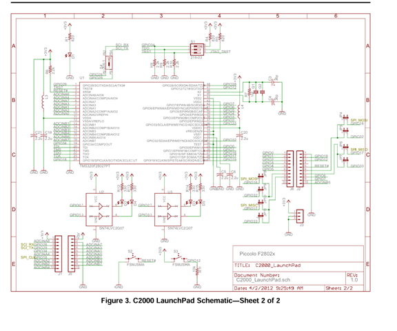

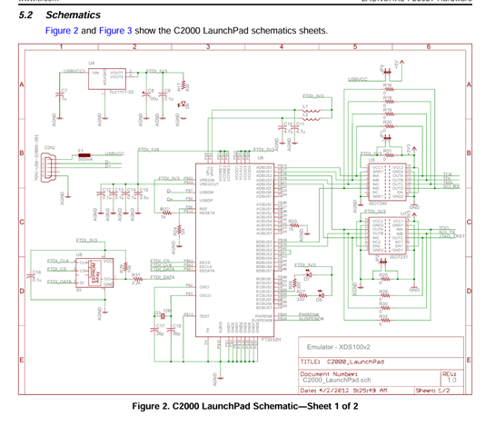

  • 您好,
    TRSTn 是否为高电平(启用 JTAG 模式)? 客户能否分享其 JTAG 连接的原理图?

  • 您好,
    看起来正确、LED D1 也指示正在正确提供 3.3V 电压。 我还在自己的 LaunchPad 上进行了测试、连接没有问题。
    对器件编程后是否发生了此问题? 您以前是否能够连接到该器件? 您可以尝试使用其他 USB 吗?
