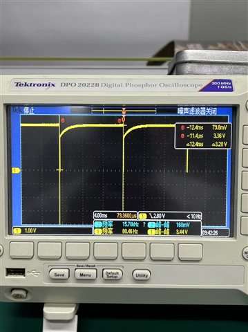

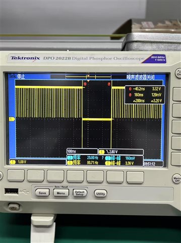

The following is the output state of the reset pin on the chip after it is powered on.

    The periodic resets are due to the watchdog being active. Are you referring to the error in regard to the period in which there are no resets occurring in the waveform image? Some more context there would be helpful for my understanding of when these waveforms were captured.
  • First of all, I would like to thank you for your reply. At present, the fault where the watchdog is constantly activated can be reproduced. The specific operation is to use the debugging tool to burn in the program that you have edited. Run it normally. After the program runs, click the "reset" button in the CCS debugging interface. At this point, measuring the reset pin can reproduce the fault.
    However, this fault phenomenon is different from the situation of the two faulty chips. Currently, it has been found that there are two chips with this fault. Before performing the above operation, reprogram one of the chips with the same code once, and the fault is eliminated. After reproducing the fault through the above operation, the fault will also be eliminated when the power is re-applied. The other faulty chip was not reprogrammed for comparison purposes, but even after re-powering, the fault could not be eliminated for this chip.

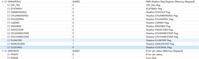

  • Thank you for your reply. Based on the ideas you provided, when checking the registers of the faulty board card, it was found that FLUNCERR and RAMUNCERR were both 1. The board card continuously triggered NMI, causing it to keep resetting. Could you please list the specific items that need to be tested in order to determine the causes of this malfunction?
  • Thank you for providing the status of the registers shown. To further debug, could you please try disabling ECC through the following register on the unit that you are re-programming and see if you still observe the issue?

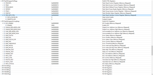

    Could you please also let me know the status of the FRD_INTF_CTRL  register? I would like to check if pre-fetch has been enabled. If it has, then please also test to see if disabling pre-fetch also removes the issue.

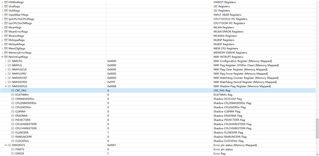

  • Hello, thank you for your reply. I used the debugger to debug the faulty chip and checked the following register states. I'm not sure if this is what you need. If it is not this register, please let me know which register is the correct one. If so, please let me know which additional data needs to be investigated.
  • Thank you for checking. The register view shows that Prefetch has been disabled (PREFETCH_EN).
    Were you able to check if you have ECC enabled or not?

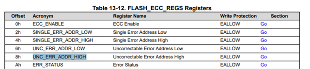

    I'd also like to view the ECC Error Address. There are two registers that capture this information in the Flash_ECC_Regs Registers
    If the error address points to a non-flash based address then please note this FAQ:  [FAQ] TMS320F28388D: [FAQ] Why does the CM core on the F2838xD device sometimes gets into an NMI exception, reporting an uncorrectable flash ECC error that points to a non-flash address at runtime?
  • Thank you for your reply. However, the image in your response cannot be loaded. Could you please resend this image so that I can better confirm the required data?
  • Hello, in the previous register screenshot, you can find the exact register value you need. This screenshot was taken after the board was powered on and was in an abnormal reset state. It was viewed using the "Load symbols only" option for debugging. It's just that the value of this register is 0.
  • Thank you for providing the clarity. When the programs enters the triggered NMI's ISR. Can you please do another read of the PREFETCH_EN, ECC_ENABLE registers and of the UNC_ERR_ADDR_LOW/HIGH registers. I'd like to see what address the uncorrectable error is pointing to when the NMI is triggered. Looking at the screenshot above the address values are still 0.
