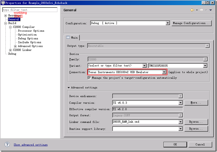

F28069在使用CCS6.1进行编译时出现(Error -151 @ 0x0)错误
F28069M在使用6.1.2.00015 版本进行编译时出现(Error -151 @ 0x0)错误:
C28xx: Error connecting to the target: (Error -151 @ 0x0) One of the FTDI driver functions used during the connect returned bad status or an error. The cause may be one or more of: invalid XDS100 serial number, blank XDS100 EEPROM, missing FTDI drivers, faulty USB cable. Use the xds100serial command-line utility in the 'common/uscif' folder to verify the XDS100 can be located. (Emulation package 6.0.14.5)
自己编写的和例程均出现此错误,但使用F28035的板子编译正常。
