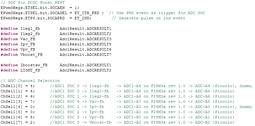

关于28M35中ADC配置的问题
太阳能开发套件的程序中有一段关于ADC配置的程序我看不懂,注释也看不懂,您能帮我解释一下么
// SOC for DCDC Boost MPPT
EPwm3Regs.ETSEL.bit.SOCAEN = 1;
EPwm3Regs.ETSEL.bit.SOCASEL = ET_CTR_PRD ; // Use PRD event as trigger for ADC SOC
   EPwm3Regs.ETPS.bit.SOCAPRD = ET_2ND;        // Generate pulse on 2nd event
#define Ileg1_fb Adc1Result.ADCRESULT1
#define Ileg2_fb Adc1Result.ADCRESULT2
#define Vac_FB Adc1Result.ADCRESULT3
#define Ipv_FB Adc1Result.ADCRESULT5
#define Vpv_FB Adc1Result.ADCRESULT6
#define Vboost_FB   Adc1Result.ADCRESULT7
#define Iboostsw_FB Adc2Result.ADCRESULT1
#define LIGHT_FB Adc2Result.ADCRESULT2
// ADC Channel Selection
ChSel1[0] = 4; //ADC1 SOC 0 -> Ileg1-fb   -> ADC1-A4 on F28M3x rev 1.0 -> ADC-A4 {Piccolo}, dummy
ChSel1[1] = 4; //ADC1 SOC 0 -> Ileg1-fb   -> ADC1-A4 on F28M3x rev 1.0 -> ADC-A4 {Piccolo}
ChSel1[2] = 6; //ADC1 SOC 1 -> Ileg2-fb   -> ADC1-A6 on F28M3x rev 1.0 -> ADC-A6 {Piccolo}
ChSel1[3] = 7; //ADC1 SOC 4 -> Vac-fb     -> ADC1-A7 on F28M3x rev 1.0 -> ADC-A5 {Piccolo}
ChSel1[4] = 0; //ADC1 SOC 2 -> Ipv-fb     -> ADC1-A0 on F28M3x rev 1.0 -> ADC-A0 {Piccolo}, dummy
ChSel1[5] = 0; //ADC1 SOC 2 -> Ipv-fb     -> ADC1-A0 on F28M3x rev 1.0 -> ADC-A0 {Piccolo}
ChSel1[6] = 8; //ADC1 SOC 3 -> Vpv-fb     -> ADC1-B0 on F28M3x rev 1.0 -> ADC-A1 {Piccolo}
ChSel1[7] = 2; //ADC1 SOC 5 -> Vboost-fb  -> ADC1-A2 on F28M3x rev 1.0 -> ADC-A2 {Piccolo}

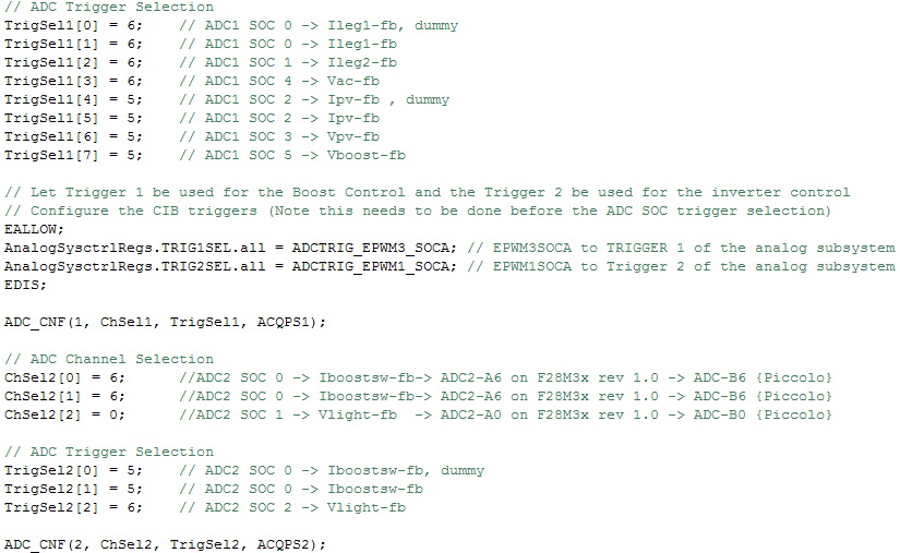

// ADC Trigger Selection
TrigSel1[0] = 6; // ADC1 SOC 0 -> Ileg1-fb, dummy
TrigSel1[1] = 6; // ADC1 SOC 0 -> Ileg1-fb
TrigSel1[2] = 6; // ADC1 SOC 1 -> Ileg2-fb
TrigSel1[3] = 6; // ADC1 SOC 4 -> Vac-fb
TrigSel1[4] = 5; // ADC1 SOC 2 -> Ipv-fb , dummy
TrigSel1[5] = 5; // ADC1 SOC 2 -> Ipv-fb
TrigSel1[6] = 5; // ADC1 SOC 3 -> Vpv-fb
TrigSel1[7] = 5; // ADC1 SOC 5 -> Vboost-fb
// Let Trigger 1 be used for the Boost Control and the Trigger 2 be used for the inverter control
// Configure the CIB triggers (Note this needs to be done before the ADC SOC trigger selection)
EALLOW;
AnalogSysctrlRegs.TRIG1SEL.all = ADCTRIG_EPWM3_SOCA; // EPWM3SOCA to TRIGGER 1 of the analog subsystem
AnalogSysctrlRegs.TRIG2SEL.all = ADCTRIG_EPWM1_SOCA; // EPWM1SOCA to Trigger 2 of the analog subsystem
EDIS;
ADC_CNF(1, ChSel1, TrigSel1, ACQPS1);
ChSel2[0] = 6; //ADC2 SOC 0 -> Iboostsw-fb-> ADC2-A6 on F28M3x rev 1.0 -> ADC-B6 {Piccolo}
ChSel2[1] = 6; //ADC2 SOC 0 -> Iboostsw-fb-> ADC2-A6 on F28M3x rev 1.0 -> ADC-B6 {Piccolo}
ChSel2[2] = 0; //ADC2 SOC 1 -> Vlight-fb  -> ADC2-A0 on F28M3x rev 1.0 -> ADC-B0 {Piccolo}
TrigSel2[0] = 5; // ADC2 SOC 0 -> Iboostsw-fb, dummy
TrigSel2[1] = 5; // ADC2 SOC 0 -> Iboostsw-fb
TrigSel2[2] = 6; // ADC2 SOC 2 -> Vlight-fb
ADC_CNF(2, ChSel2, TrigSel2, ACQPS2);

代码粘贴乱的话请看一下图片吧
