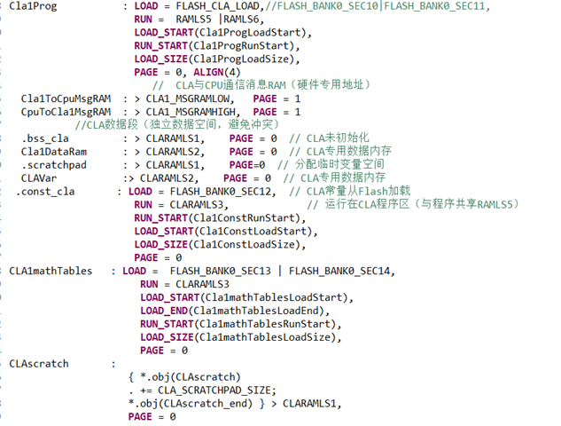

问题描述:选择的软件触发任务,TASK 任务选择的是由.cla文件格式的C形式的程序,TASK任务无法被触发。而我之前配置的CLA TASK 任务是由.asm文件格式汇编编写的,是能够被触发更新EPWM周期。由于后期程序量增加,我将TASK任务由汇编改为了C形式,任务就不能被触发,加上  __mdebugstop();测试,也是不能停止。下边是我关于CLA的配置:

void CLA_Init(void)
    EALLOW;
    CpuSysRegs.PCLKCR0.bit.CLA1 = 1;
    Cla1Regs.MCTL.bit.HARDRESET = 1;
    __asm(" RPT #3 || NOP");
    EDIS;
    EALLOW;
    memcpy((uint32_t *)&Cla1ProgRunStart, (uint32_t *)&Cla1ProgLoadStart,(uint32_t)&Cla1ProgLoadSize);
    memcpy((uint32_t *)&Cla1ConstRunStart, (uint32_t *)&Cla1ConstLoadStart,(uint32_t)&Cla1ConstLoadSize);
 memcpy((uint32_t *)&Cla1mathTablesRunStart, (uint32_t *)&Cla1mathTablesLoadStart, (Uint32)&Cla1mathTablesLoadSize);
    MemCfgRegs.MSGxINIT.bit.INIT_CLA1TOCPU = 1;
    while(MemCfgRegs.MSGxINITDONE.bit.INITDONE_CLA1TOCPU != 1){};
    MemCfgRegs.MSGxINIT.bit.INIT_CPUTOCLA1 = 1;
    while(MemCfgRegs.MSGxINITDONE.bit.INITDONE_CPUTOCLA1 != 1){};

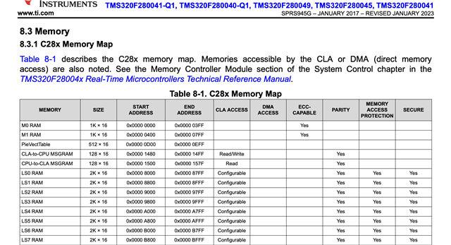

    MemCfgRegs.LSxMSEL.bit.MSEL_LS5 = 1;
    MemCfgRegs.LSxCLAPGM.bit.CLAPGM_LS5 = 1;
    MemCfgRegs.LSxMSEL.bit.MSEL_LS6= 1;
    MemCfgRegs.LSxCLAPGM.bit.CLAPGM_LS6 = 0;
      Cla1Regs.MVECT2 = (Uint16)(&Cla1Task2);
    __asm(" RPT #7 || NOP");
//DmaClaSrcSelRegs.CLA1TASKSRCSEL1.bit.TASK1=CLA_TRIG_NOPERPH;//ADCA1INT
DmaClaSrcSelRegs.CLA1TASKSRCSEL1.bit.TASK2=CLA_TRIG_ADCAINT1;//CLA_TRIG_NOPERPH;//CLA_TRIG_ADCAINT1
   Cla1Regs.MCTL.bit.IACKE = 1;
    Cla1Regs.MIER.all = (M_INT1 |M_INT2); //M_INT1;//
    IER |= (M_INT11);
    Cla1ForceTask2();
    EDIS;

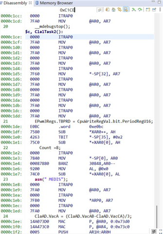

TASK2 任务由C语言形式写的:
#pragma CODE_SECTION(Cla1Task2, "Cla1Prog")
__interrupt  void Cla1Task2 (void)
    asm(" MEALLOW");
    __mdebugstop();
    EPwm3Regs.TBPRD = CpuWriteRegVal.bit.PeriodRegU16;
//    PFCLp.Count ++;
    asm(" MEDIS");
  __asm(" MSTOP ")
},问题现象让我不明白,不同的TASK任务实现形式是有什么不同要求吗,为什么汇编的变现出正常触发,C语言形式中断进不去呢?
