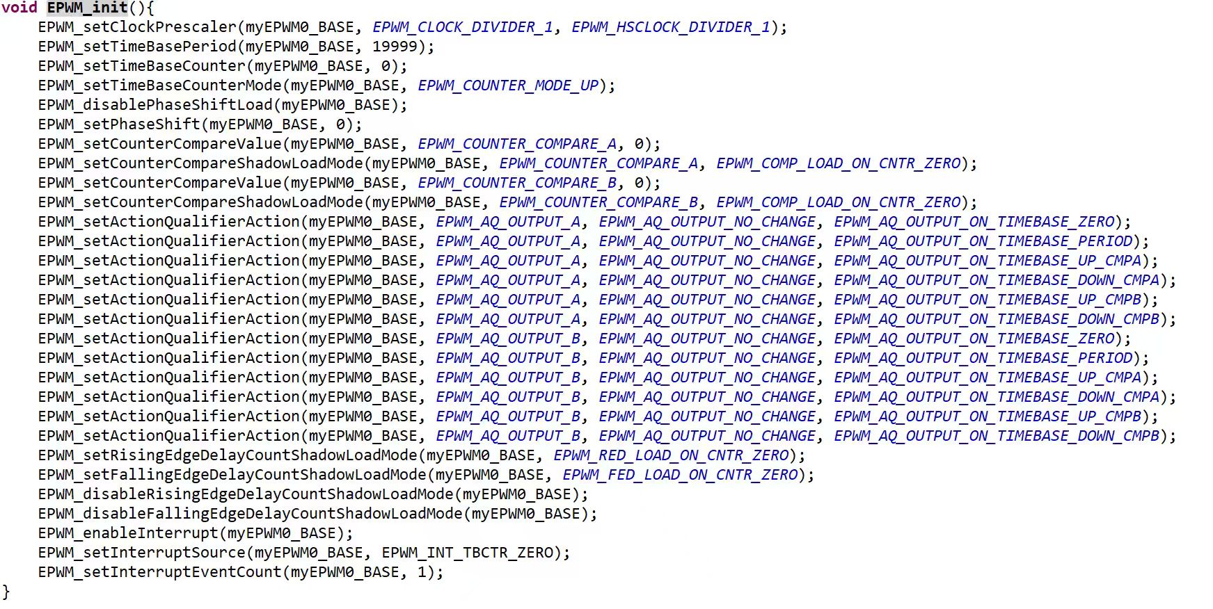

Part Number: TMS320F28379D-Q1

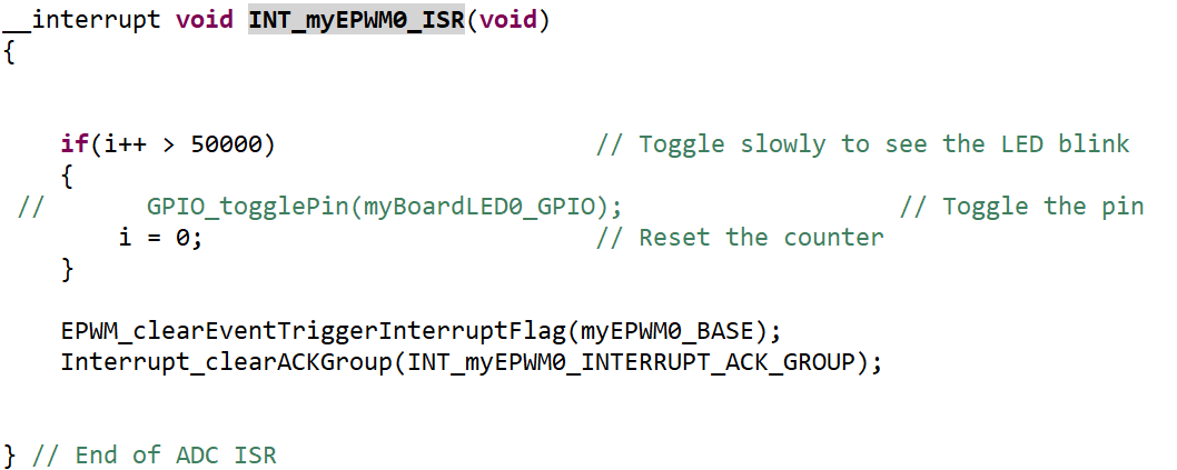

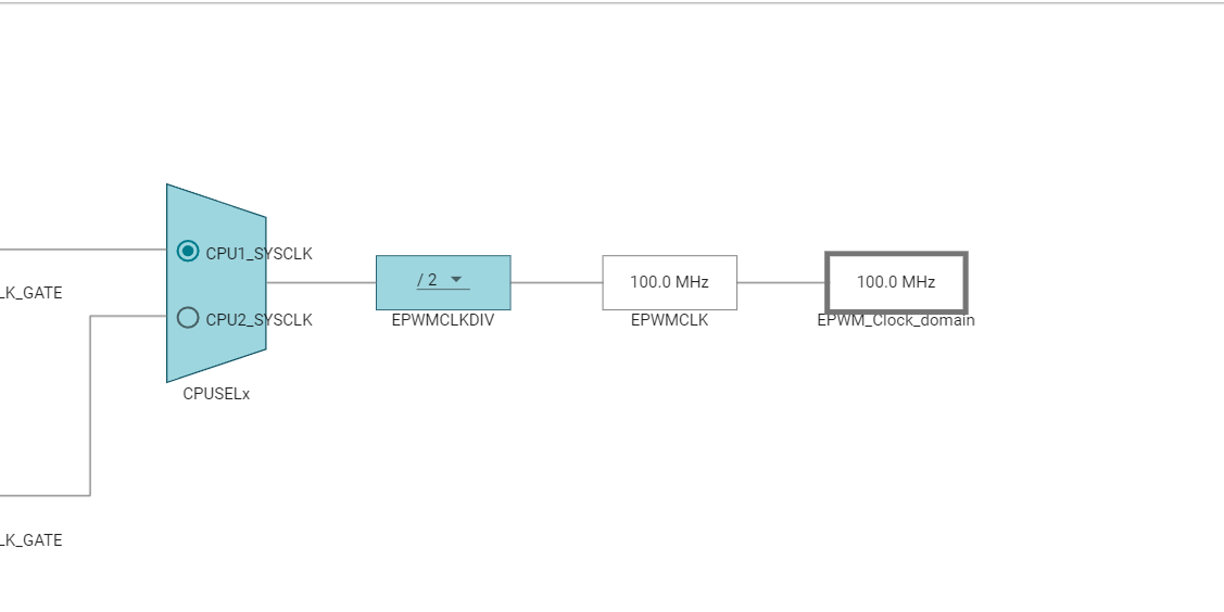

In F28379D, I imported the "empty_lab" from the "training" section in the c2000ware. I configured the epwm interrupt using syscfg. My epwmclock is 100 MHz, TBPRD is 1999, and it uses the upward counting mode. Each time an interrupt is triggered, the interrupt frequency should be 50 kHz. However, after my counting test, I found that the actual interrupt frequency is only 25 kHz. Currently, I cannot solve this problem and I don't know where the issue lies.dd8556ae874c5e37208b076eb1905e79.png52243d45d0401b3125fd2e78d8b12c83.jpg0c93066fcb1f2ef6f5e04edda45db02a.png
