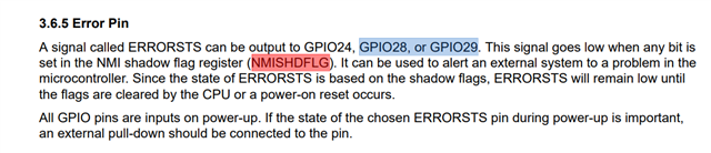

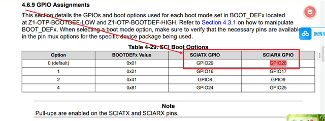

如下代码,想控制GPIO28输出0/1,无法控制,GPIO28一直输出0
        GPIO_setDirectionMode(28, GPIO_DIR_MODE_OUT);
        GPIO_setQualificationMode(28, GPIO_QUAL_SYNC);
        GPIO_setPinConfig(GPIO_28_GPIO28);
        GPIO_setPadConfig(28, GPIO_PIN_TYPE_STD);
