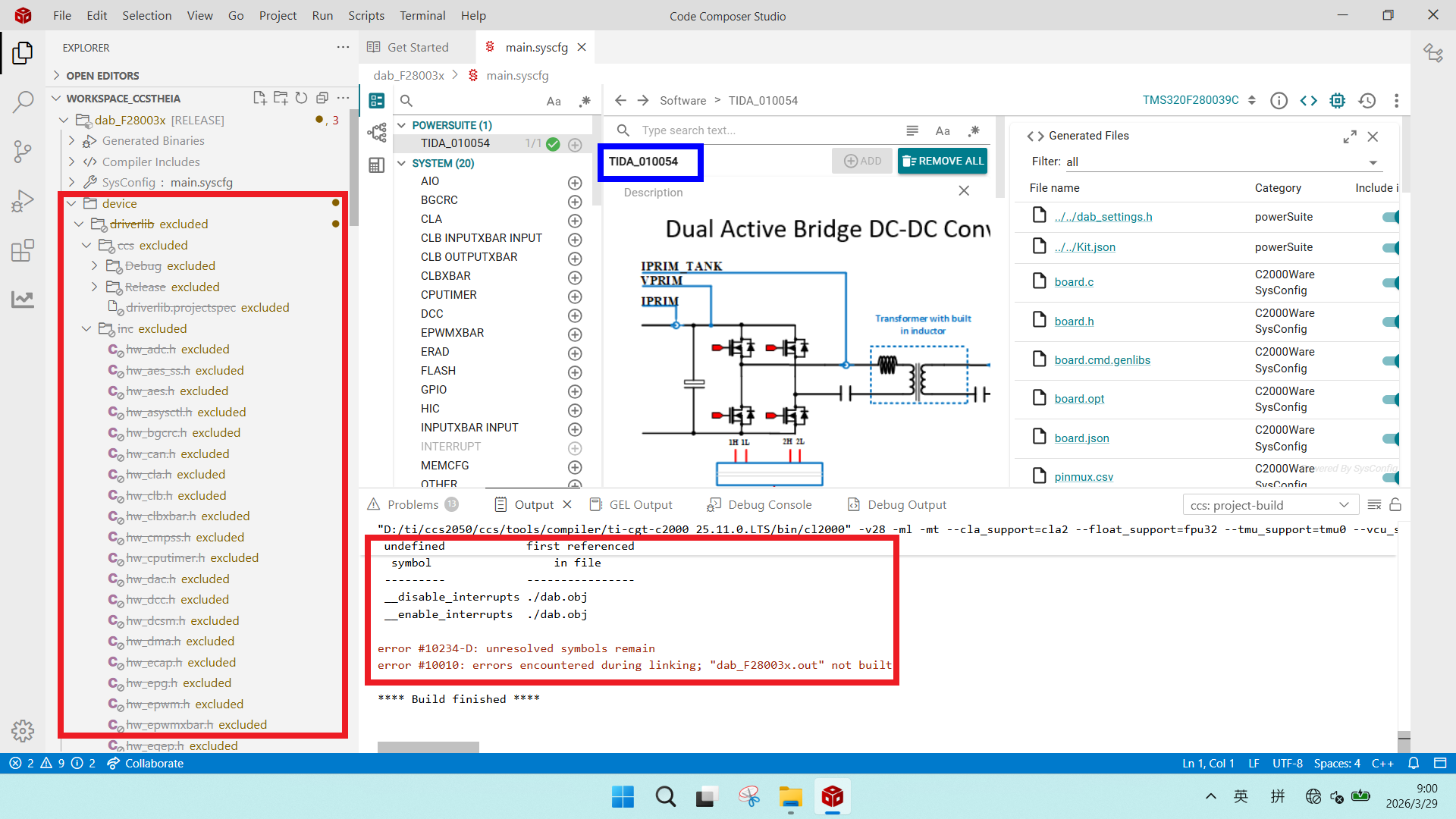

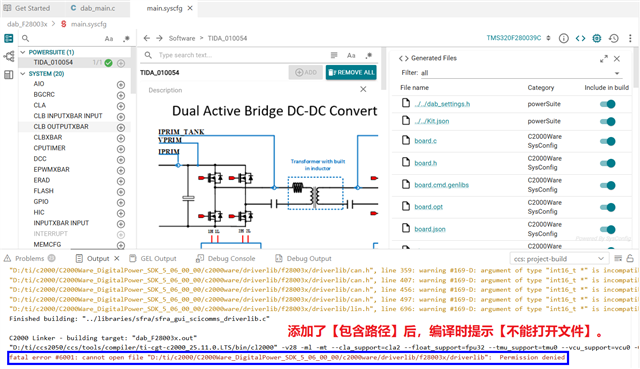

When importing the "Reference Guide TIDA-010054" project with CCS 20.5.0, during compilation, it reports:"in the dab.obj file, undefined symbol '__disable_interrupts' and '__enable_interrupts' ". However, in the "dab.c" and "dab.h" files, the symbols "__disable_interrupts" and "__enable_interrupts" cannot be found.
In addition, in the left-hand list of CCS, items such as "drivelib excluded" and "ccs excluded" appear. Please advise on how to resolve these two issues.

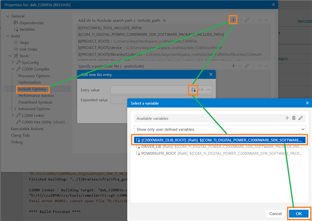

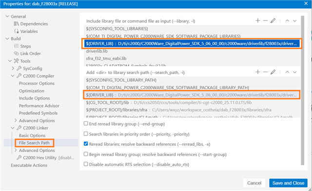

    The project "Reference Guide TIDA-010054" originates from the folder “D:\ti\c2000\C2000Ware_DigitalPower_SDK_5_06_00_00\solutions\tida_010054\f28003x\ccs”.
    Project Properties → Tools → C2000 Compiler:
    Project Properties → Tools → C2000 Linker:
  • Supplement:
  • Hello,
         It seems there is not driverlib available, is C2000Ware  installed?
  • Thank you for the reply, Alice! I have already installed C2000Ware.

    The header file "dab.h" includes the header file "DCLF32.h", and "DCLF32.h" in turn includes the header file "DCL.h". In two inline functions within "DCL.h", the characters "__disable_interrupts()" and "__enable_interrupts()" were found. However, these two inline functions are not linked to the file.
    Adding the statement "#define __TMS320C28xx__" here to define the macro __TMS320C28xx__ results in the following compilation error: "__TMS320C28xx__ is predefined; redefinition ignored."

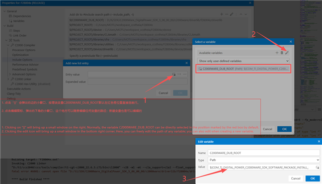

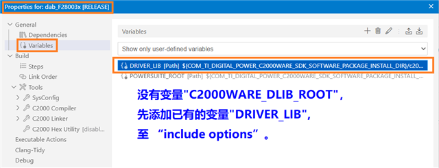

  • 我遇到了你一样的问题并且解决了。你看你这个包含的库是不是没有路径。我导进来默认就没有路径,要自己改
  • 你好!
    感谢会员 Vayn Scmyst 答复我的问题。

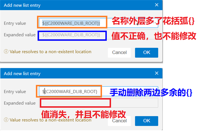

    配置中添加三个入口参数时,都不能输入它们的扩展值。见下面的几个截图:
    Hello!
    I would like to thank member Vayn Scmyst for responding to my question.
    When adding three ENTRY parameters in the configuration, their EXPANDED VALUES values cannot be entered. Please refer to the screenshots below:
    打开“.cproject” 文件,发现了这些配置参数,但参数后面也都没有它们的值,好像它们的值是自动获取的,不能修改。
    Upon opening the ".cproject" file, these configuration parameters were found, but none of them had values assigned. It appears that their values are automatically retrieved and cannot be modified.
    Best regards.
    Yong Liu

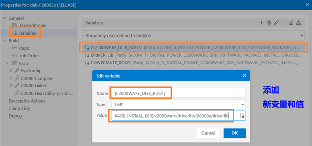

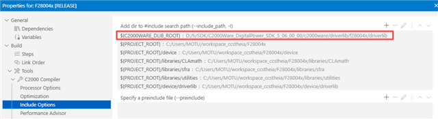

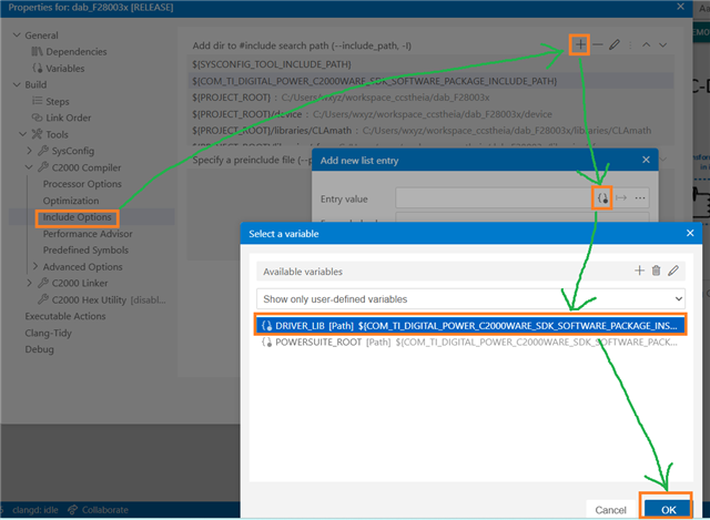

  • 1、先添加已有的变量尝试:
    2、再添加新变量尝试:
    仍然不能输入或修改值。
    中文论坛的服务器好像在国外。登录、上传图片网页反应很迟缓,发帖子很困难,经常提示账户有问题!

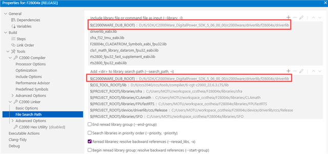

    Importing the official project "TIDM-02002 - Bi-Directional CLLLC Resonant Dual Active Bridge (DAB) for HEV-EV Onboard Charger" (TMS320F28004x), also gives errors:
    undefined symbol __disable_interrupts ./clllc.obj __enable_interrupts ./clllc.obj
    The above example also uses "DCL.h".
