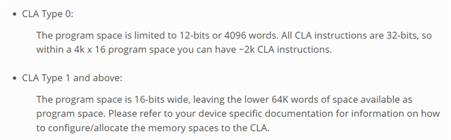

4. Frequently Asked Questions — C2000 CLA Software Guide "
