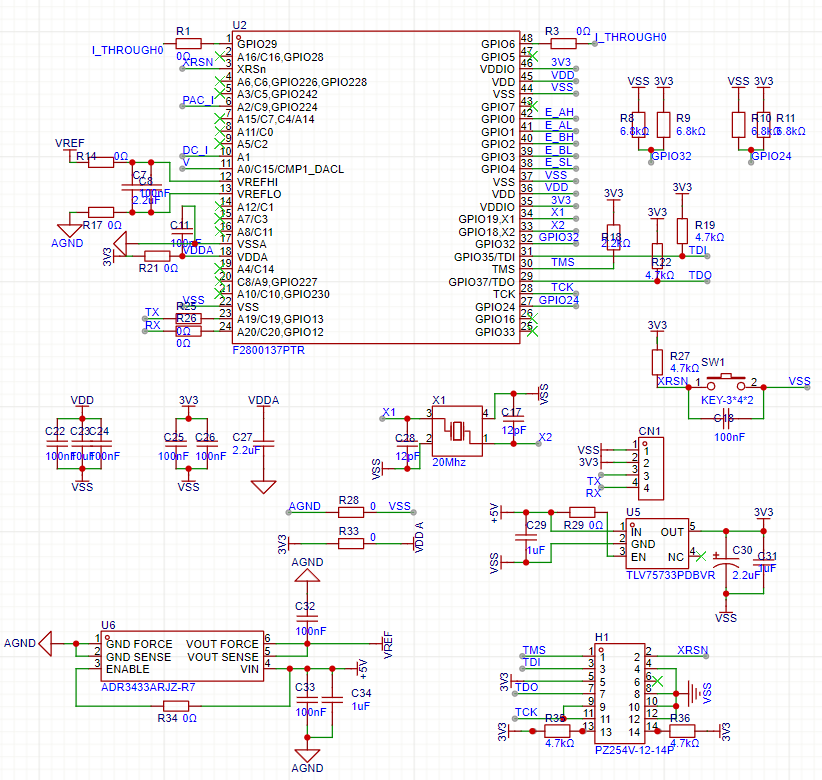

F2800137PTR芯片无法正常烧录程序,检查了GPIO24和GPIO32都拉高了,并且XRSN拉高了,电源电压也是正常的,烧录时报错,显示
C28xx_CPU1: File Loader: Verification failed: Values at address 0x000000@Program do not match Please verify target memory and memory map.
C28xx_CPU1: GEL: File: D:\TI\workspace_F2800137\F2800137_Sync_Rectifier_soft\CPU1_RAM\F2800137_Sync_Rectifier_soft.out: a data verification error occurred, file load failed.
此外,还有另外一个报错
This error is generated by TI's UScIF driver or utilities.
is --260' (0xfffffefc).The valueThe title is SC_ERR_XDS110_OPEN'
The explanation is:
An attempt to connect to the XDS11e failed.The cause may be one or more of: no XDS11e is connected, invalidfirmware update, invalid XDS11e serial number, or faulty Usscable. The firmware and serial number may be updated using thexdsdfu utility found in the.../ccs_base/common/uscif/xdsi1edirectory of your installation. View the XDs11esupportReadMe.pdffile there for instructions
De available from
[End: Texas Instruments XDS11e USB Debug Probe_e]
下面是电路图
