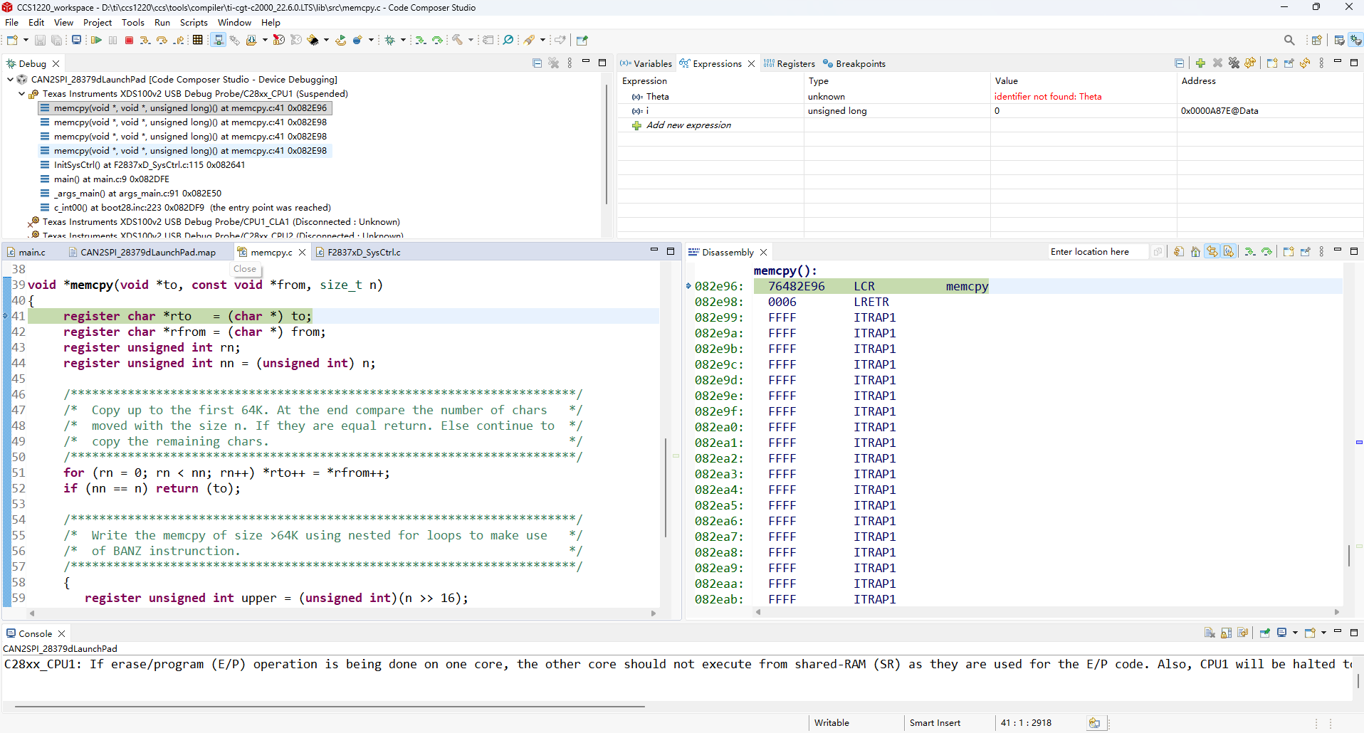

I am encountering an initialization issue with a register-based project on the TMS320F28379D LaunchPad. The code hangs inside the compiler's memcpy.c file during the Flash-to-RAM copy process.
Here are the details of my setup and the troubleshooting steps I've taken:
1. Hardware & Software Environment
  • MCU: TMS320F28379D (on LAUNCHXL-F28379D)
  • IDE: CCS 12.2 (installed on both Desktop and Laptop)
  • Compiler: TI v22.6.0.LTS
  • Desktop PC Packages: C2000Ware_5_04_00_00, C2000Ware_MotorControl_SDK_5_03_00_00, C2000Ware_4_03, controlSUITE 3.49
  • Laptop PC Packages: C2000Ware_4_03
2. Project Details I have two register-based projects, both configured to run from Flash:
  • Old Project: A long-used project. The exact C2000Ware version for its original CMD files is untraceable.
  • New Project: Created today using files provided in C2000Ware 5.04.
  • CMD Files Used: 2837xD_FLASH_lnk_cpu1.cmd and F2837xD_Headers_nonBIOS_cpu1.cmd.
3. Issue Description Because both projects use the DELAY_US() function, I defined the _FLASH macro to copy the time-critical functions to RAM.
During debugging on the Desktop, the initialization code gets stuck in the compiler library file: D:\ti\ccs1220\ccs\tools\compiler\ti-cgt-c2000_22.6.0.LTS\lib\src\memcpy.c Specifically, it hangs at this line: register char *rto = (char *) to; (See attached screenshot)
4. Cross-Testing & Observations To isolate the issue, I ran tests across both PCs and projects:
  • Desktop + New Project: Hangs at memcpy.c.
  • Desktop + Old Project: Was working fine earlier today, but later started exhibiting the exact same memcpy.c hang issue.
  • Laptop + Old Project: Works perfectly without any issues.
  • Laptop + New Project: Hangs at memcpy.c. Even if I replace the New Project's CMD files with the Old Project's CMD files, the issue persists.
  • Optimization Levels: The Old Project uses O2. For the New Project, I tried both O2 and off, but the issue remains.
5. Attachments I have attached the .cmd and .map files of the New Project (from the Desktop) for your reference.
Could you please help me identify why memcpy is failing and how to properly configure the Flash-to-RAM copy for DELAY_US() in the latest C2000Ware? Thank you!
