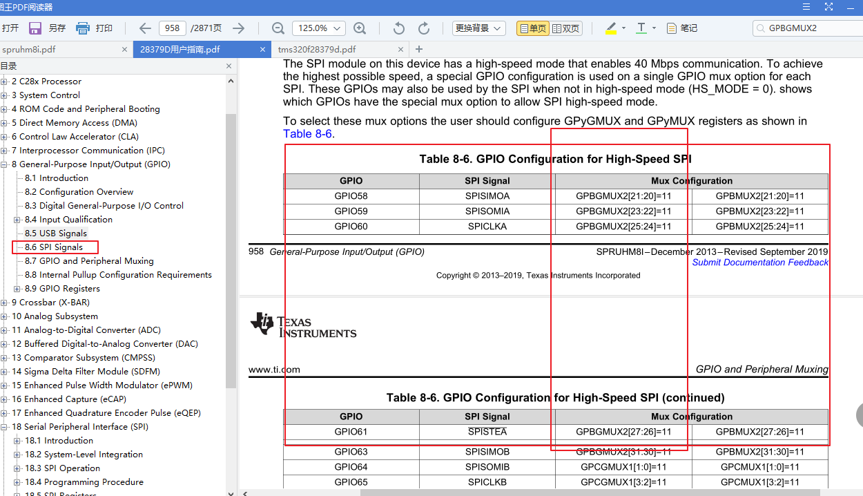

  • 破案了
    要加一排寄存器的配置

     /* Configure SPI-A pins using GPIO regs*/
     // This specifies which of the possible GPIO pins will be SPI functional pins.
     // Comment out other unwanted lines.
         GpioCtrlRegs.GPBGMUX2.bit.GPIO58 = 3; // Configure GPIO16 as SPISIMOA
     //  GpioCtrlRegs.GPAMUX1.bit.GPIO5 = 2;  // Configure GPIO5 as SPISIMOA
         GpioCtrlRegs.GPBGMUX2.bit.GPIO59= 3; // Configure GPIO17 as SPISOMIA
     //  GpioCtrlRegs.GPAMUX1.bit.GPIO3 = 2;  // Configure GPIO3 as SPISOMIA
         GpioCtrlRegs.GPBGMUX2.bit.GPIO60 =3; // Configure GPIO18 as ***
         GpioCtrlRegs.GPBGMUX2.bit.GPIO61 = 3; // Configure GPIO19 as SPISTEA
         GpioCtrlRegs.GPBMUX2.bit.GPIO58 = 3; // Configure GPIO16 as SPISIMOA
         GpioCtrlRegs.GPBMUX2.bit.GPIO59= 3; // Configure GPIO17 as SPISOMIA
         GpioCtrlRegs.GPBMUX2.bit.GPIO60 =3; // Configure GPIO18 as ***
         GpioCtrlRegs.GPBMUX2.bit.GPIO61 = 3; // Configure GPIO19 as SPISTEA
         EDIS;
    也就是要加这个GPBGMUX2的寄存器配置才能用。
