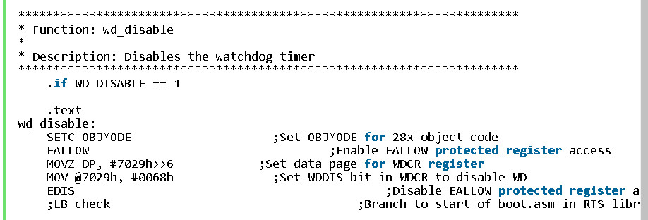

2.修改bootloader工程的codestart.asm的汇编文件,如下所示,
WD_DISABLE	.set	1				;set to 1 to disable WD, else set to 0
   	.ref _c_int00
    .global code_start
* Function: codestart section
* Description: Branch to code starting point
    .sect "codestart"
code_start:
    .if WD_DISABLE == 1
        LB wd_disable       			;Branch to watchdog disable codex
   	.else
        ;LB _c_int00         ;Branch to start of boot.asm in RTS library
        LB check
    .endif
;end codestart section
* Function: wd_disable
* Description: Disables the watchdog timer
    .if WD_DISABLE == 1
    .text
wd_disable:
    SETC OBJMODE       		 		;Set OBJMODE for 28x object code
    EALLOW              					;Enable EALLOW protected register access
    MOVZ DP, #7029h>>6  			;Set data page for WDCR register
    MOV @7029h, #0068h  			;Set WDDIS bit in WDCR to disable WD
    EDIS                							;Disable EALLOW protected register access
    ;LB check        							;Branch to start of boot.asm in RTS library
check:
	MOVL	XAR0, #0x338000   	;
	CMP  *XAR0, #0x28AD        	;never update before;
	B app, EQ
	LB search
addPTR:
	ADDB XAR0, #0x4
search:
	CMP *XAR0, #0xFFFF
	B addPTR, NEQ
	SUBB XAR0, #0x4
	CMP *XAR0, #0xFFF0
	B app, EQ
	LB _c_int00
app:
	MOVL XAR7, #0x300000
	LB *XAR7
    .endif
;end wd_disable
	.end
问题是:
在JTAG进行在线仿真调试的时候,发现程序无法正常启动,也无法跳转到app main函数的入口地址处运行??
因为第一次尝试做相关的升级项目,定位问题可能不够清晰,如果有任何说得不清楚的地方,望能及时指出,我及时补充。
