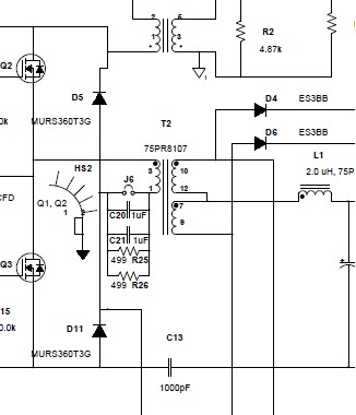

HVPSFB的VMC模式要把base board上的J6去掉吗?
  • It should be noted that with VMC
    implementation there is a need to include a DC blocking capacitor in the transformer primary to avoid
    possible transformer saturation from flux imbalance over time. Therefore, jumper J6 in Figure 10 should
    be removed for the VMC implementation
    是为了防止偏磁的,正常跑跑也没有问题。
  • 请问pcmc换成vmc,具体过程是啥呢?我看手册了,但是我的步骤搞出来以后没有输出,我估计是连接错误了。请教一下你是怎么改的
