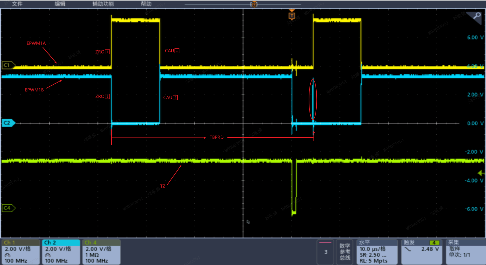

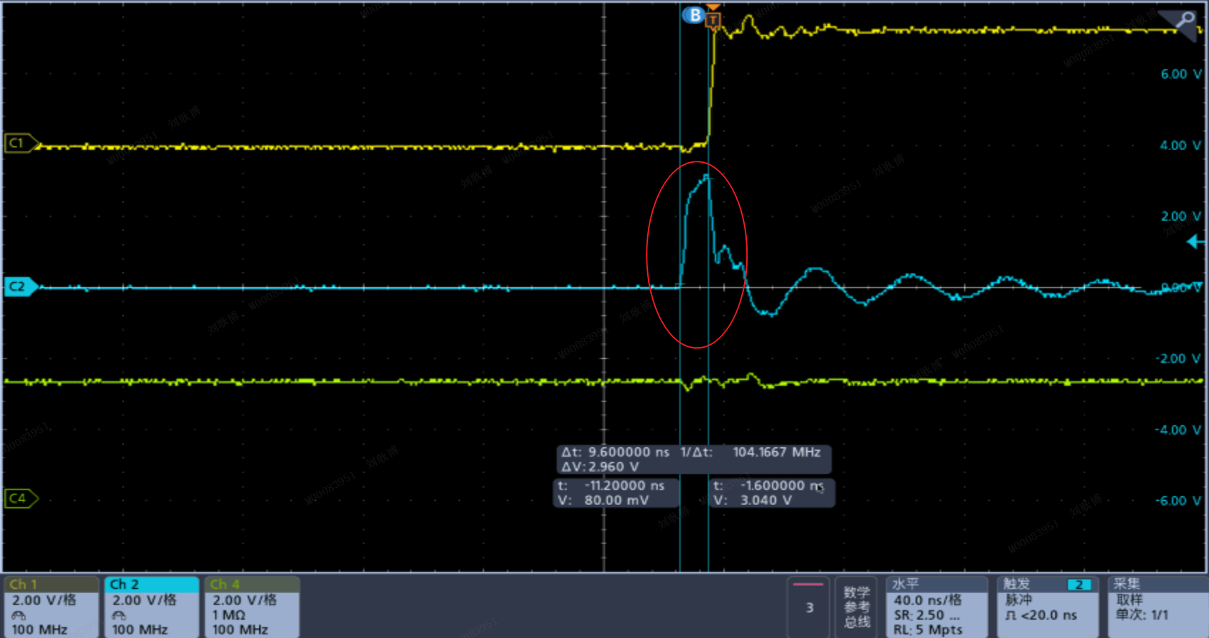

采用GPIO6作为CBC事件源,当GPIO6为低电平时EPWM1A\EPWM1B拉低。参考datasheet可知,CBC事件消除后,在下一个PWM CTR=ZERO时,CBC trip 会自动清除。实际测试时会发现EPWM1B会在清零前出现1-2CLK高电平,如下图所示。
Using GPIO6 as the CBC event source, EPWM1A/EPWM1B will go low when GPIO6 is at a low level. According to the datasheet, when the TZ TRIP is no longer present, the CBC trip will automatically clear at the next PWM CTR=ZERO. In actual testing, it can be observed that EPWM1B will show a 1-2CLK high level before clearing, as shown in the figure below.
部分放大图:
Partial enlarged view:
部分代码如下:Some code:

我的疑问:为什么在PWM周期未过零时,EPWM1B会出现短暂高电平?
My question is: why does EPWM1B exhibit a brief high level when the PWM cycle has not crossed zero?
