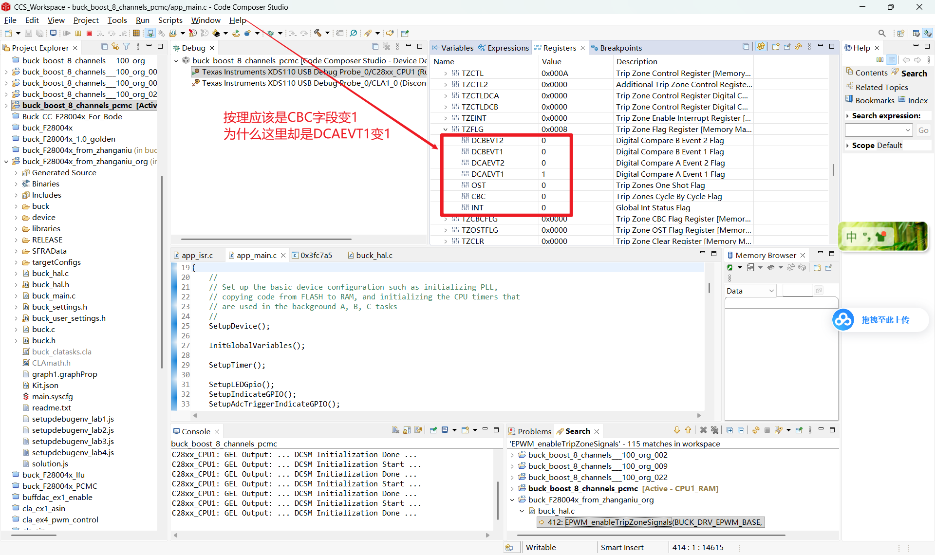

buck项目,PCMC模式(峰值电流),
需要用到MCU的比较器,自动比较电流达到阈值,则关闭PWM波,等到下一个PWM周期,再自动发新的PWM波
这需要用PWM的CBC(逐周期)保护功能
请问下面的初始化代码有问题吗?
调试时,观测CCS上的PWM寄存器值,不符合预期(见下面的图, 按理应该是CBC字段变1,为什么这里却是DCAEVT1变1 )
void SetupProtectionForOnePwm(uint32_t pwmBase, EPWM_DigitalCompareTripInput tripSource)
    // Enable trip4 code
    //Trip 4 is the input to the DCAHCOMPSEL
    EPWM_selectDigitalCompareTripInput(pwmBase, tripSource, EPWM_DC_TYPE_DCAH);
    EPWM_setTripZoneDigitalCompareEventCondition(pwmBase, EPWM_TZ_DC_OUTPUT_A1, EPWM_TZ_EVENT_DCXH_HIGH);
    EPWM_setDigitalCompareEventSource(pwmBase, EPWM_DC_MODULE_A, EPWM_DC_EVENT_1, EPWM_DC_EVENT_SOURCE_FILT_SIGNAL);
    EPWM_setDigitalCompareEventSyncMode(pwmBase, EPWM_DC_MODULE_A, EPWM_DC_EVENT_1,EPWM_DC_EVENT_INPUT_NOT_SYNCED);

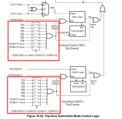

    // DCxEVTn管多个周期,一旦DCxEVTn标志被置上后,标志不会被自动清除,需要软件去把标志清除
    //EPWM_enableTripZoneSignals(pwmBase, EPWM_TZ_SIGNAL_DCAEVT1);
    EPWM_enableTripZoneSignals(pwmBase, EPWM_TZ_SIGNAL_CBC6);  // Emulator Stop
    //EPWM_enableTripZoneSignals(pwmBase, EPWM_TZ_SIGNAL_OSHT1); // one-shot trip1
    // TZA events can force EPWMxA
    // TZB events can force EPWMxB
    EPWM_setTripZoneAction(pwmBase, EPWM_TZ_ACTION_EVENT_TZA, EPWM_TZ_ACTION_LOW);
    EPWM_setTripZoneAction(pwmBase, EPWM_TZ_ACTION_EVENT_TZB, EPWM_TZ_ACTION_LOW);
    // Clear any spurious trip
    EPWM_clearTripZoneFlag(pwmBase, (EPWM_TZ_FLAG_OST | EPWM_TZ_FLAG_CBC |
                                     EPWM_TZ_FLAG_DCAEVT1|
                                     EPWM_TZ_FLAG_DCBEVT1));
按理应该是CBC字段变1
为什么这里却是DCAEVT1变1
