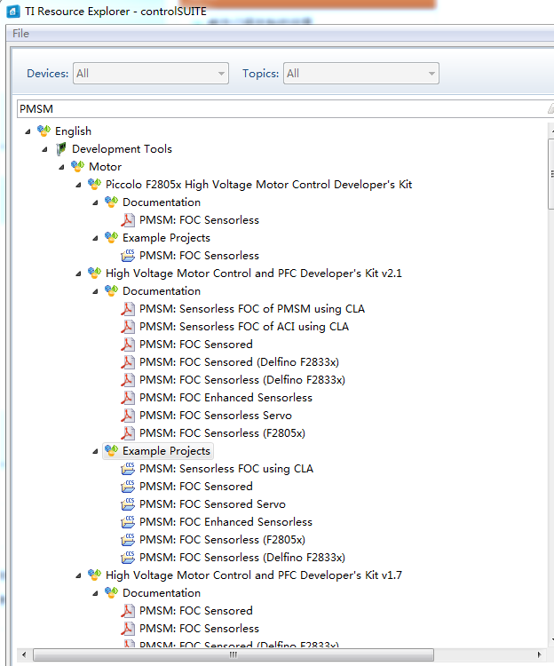

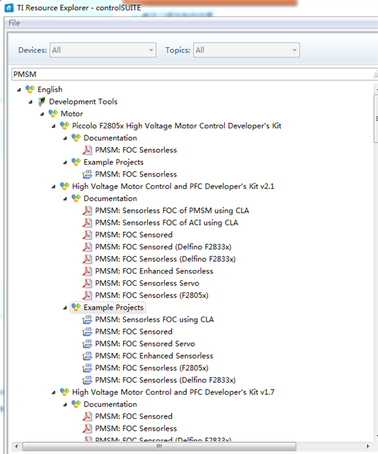

怎样在controlsuite里面找到PMSM的双闭环调速例程?路径是什么?谢谢!
参考下面例程:
C:\ti\controlSUITE\development_kits\HVMotorCtrl+PfcKit_v2.1\HVPM_Sensored_Servo
