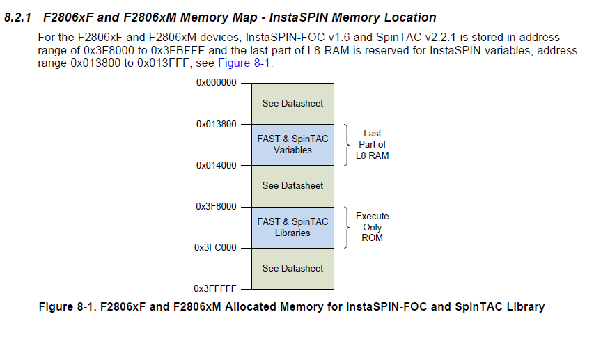

  • 两款芯片IQTABLES地址不一样 :
    F2806xF/M
    IQTABLES : origin = 0x3FDC30, length = 0x000B50 /* IQ Math Tables in Boot ROM */
    IQTABLES2 : origin = 0x3FE780, length = 0x00008C /* IQ Math Tables in Boot ROM */
    IQTABLES3 : origin = 0x3FE80C, length = 0x0000AA /* IQ Math Tables in Boot ROM */
    F2806x:
    IQTABLES : origin = 0x3FDF00, length = 0x000B50 /* IQ Math Tables in Boot ROM */
    IQTABLES2 : origin = 0x3FEA50, length = 0x00008C /* IQ Math Tables in Boot ROM */
    IQTABLES3 : origin = 0x3FEADC, length = 0x0000AA /* IQ Math Tables in Boot ROM */
    另外F2806xF/M L8-RAM下面这部分地址要保留给FAST
