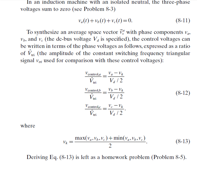

向大家请教一个问题:
SVPWM一般采用7段式或者5段式生成,需要考虑合成磁场所在位置。最近学习TI 的C2000-launchpad TMS320f28027F 永磁无刷电机控制,发现这么一段SVPWM产生的代码,很不理解,希望大家能给予一些指导。

无法理解TI 这个程序SVPWM是怎么产生的,谁能推荐一些质料哈,感激不尽
相关原理可以参考一下:
C:\ti\controlSUITE\libs\app_libs\motor_control\math_blocks
也可以百度一下。
我们产品线的回答,自己翻译一下:
The SVM technique used with InstaSPIN is discussed in the following reference:
Advanced Electric Drives, Analysis, Control and Modeling using Simulink, by Ned Mohan, MNPERE Press, Minneapolis, MN 55414, 2001, ISBN# 0-9715292-0-5
This technique was selected because it seamlessly transitions into the overmodulation region of operation by simply increasing the amplitude of the voltage variables from the Inverse Park Transform. A natural clipping effect occurs which causes the waveforms to change from sinusoidal to trapezoidal.
You can replace the SVM module with a more conventional technique if you desire. But you must then manage the overmodulation yourself.
Eric
首先向您表示衷心的感谢,这段代码从其他TI的程序中也有看到,在SVGEN_COMM.H中有这么一段代码:
#define SVGENCOMM_MACRO(v)
v.tmp1=_IQdiv2(v.Ualpha);
v.tmp2=_IQmpy(_IQ(0.8660254),v.Ubeta);
v.Va = v.Ualpha;
v.Vb = -v.tmp1 + v.tmp2;
v.Vc = -v.tmp1 - v.tmp2;
if (v.Va>v.Vb) {v.Vmax=v.Va; v.Vmin=v.Vb;}
else {v.Vmax=v.Vb; v.Vmin=v.Va;}
if (v.Vc>v.Vmax) v.Vmax=v.Vc;
if (v.Vc<v.Vmin) v.Vmin=v.Vc;
v.Vcomm = _IQdiv2(v.Vmax+v.Vmin);
v.Ta = v.Va-v.Vcomm;
v.Tb = v.Vb-v.Vcomm;
v.Tc = v.Vc-v.Vcomm;
#endif // __SVGEN_COMM_H__
也是用了最大值和最小值的平均值算公共点电压,好像和相位补偿有关。
http://caoyunfei2012.blog.163.com/blog/static/26640605220169831929763/, 这本书就不用买了,上面只有一个干巴巴的公式,需要你自己证明。可以去看看上面那个连接
