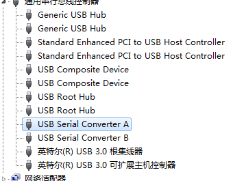

The value is '-151'无法连接,硬件管理显示USB serial converter AB,驱动2.12.18
This error is generated by TI's USCIF driver or utilities.
The value is '-151' (0xffffff69).
The title is 'SC_ERR_FTDI_OPEN'.
The explanation is:
One of the FTDI driver functions used during
the connect returned bad status or an error.
The cause may one or more of: invalid emulator serial number,
blank emulator EEPROM, missing FTDI drivers, faulty USB cable.
Use the xds100serial command-line utility in the 'common/uscif'
folder to verify the emulator can be located.
[End: Texas Instruments XDS100v1 USB Emulator_0]
显示这个,驱动下载了很多版本,官网的,独立的都更新试过了还是不行
HVMTRPFCKIT黑色那个,XDS100v1,win7,CCS6.1
有没有大神帮忙解决一下,一起买的另一个白色的可以连接,这个黑色的怎么都连不上。。
  • 白色的可以在USB认出来TI XDS100,黑色的就不行,上电顺序没有问题就是连不上
  • 有可能是XDS100的EEPROM没有烧写正确,请参考下面网址解决:
    http://processors.wiki.ti.com/index.php/XDS100?keyMatch=XDS100 V1&tisearch=Search-EN#Q:_I_was_following_Debugging_JTAG_Connectivity_Problems_and_I_a_-151_SC_ERR_POD_OPEN_error_with_Dbgjtag.
