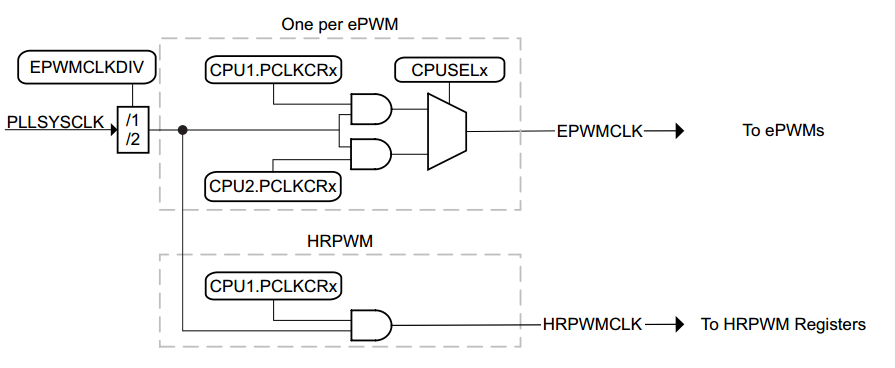

F28377D的ePWM频率问题
用的controlsuite里的epwm_deadband_cpu01例程,配置ePWM的频率的时候感觉不对:
// PLLSYSCLK = (XTAL_OSC) * (IMULT + FMULT) / (PLLSYSCLKDIV)
1、
InitSysPll(XTAL_OSC, IMULT_20, FMULT_0, PLLCLK_BY_2);
这个怎么我算的是20M的,是不是哪里还可以设成200M的呢?
2、
EPwm1Regs.TBPRD = 8000; // Set timer period
EPwm1Regs.TBPHS.bit.TBPHS = 0x0000; // Phase is 0
EPwm1Regs.TBCTR = 0x0000; // Clear counter
// Setup TBCLK
EPwm1Regs.TBCTL.bit.CTRMODE = TB_COUNT_UPDOWN; // Count up
EPwm1Regs.TBCTL.bit.PHSEN = TB_DISABLE; // Disable phase loading
EPwm1Regs.TBCTL.bit.HSPCLKDIV = TB_DIV1; // Clock ratio to SYSCLKOUT
EPwm1Regs.TBCTL.bit.CLKDIV = TB_DIV1;
我设置的不分频,按照技术手册上的计算ePWM的频率Fpwm=1/(2*TBPRD*Ttbclk)得出12.5K,结果是6.25K,是不是Ttbclk哪里还要配置呢?
3、
// Active High PWMs - Setup Deadband
EPwm1Regs.DBCTL.bit.OUT_MODE = DB_FULL_ENABLE;
EPwm1Regs.DBCTL.bit.POLSEL = DB_ACTV_HIC;
EPwm1Regs.DBCTL.bit.IN_MODE = DBA_ALL;
EPwm1Regs.DBRED.bit.DBRED = 100;
EPwm1Regs.DBFED.bit.DBFED = 100;
配置死区,按照Ttbclk=100M计算,结果时正确的。
所以是不是哪里还有设置ePWM的CLK的地方呢? 谢谢了!
