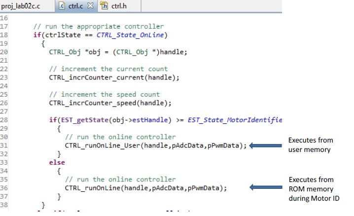

1.lab02b相对lab02a将ctrl_run()函数开源,
2.控制器有三种状态:
if(ctrlState == CTRL_State_OnLine)
CTRL_Obj *obj = (CTRL_Obj *)handle;
// increment the current count
CTRL_incrCounter_current(handle);
// increment the speed count
CTRL_incrCounter_speed(handle);
if(EST_getState(obj->estHandle) >= EST_State_MotorIdentified)
// run the online controller
CTRL_runOnLine_User(handle,pAdcData,pPwmData);
else
CTRL_runOnLine(handle,pAdcData,pPwmData);
else if(ctrlState == CTRL_State_OffLine)
// run the offline controller
CTRL_runOffLine(handle,halHandle,pAdcData,pPwmData);
else if(ctrlState == CTRL_State_Idle)
// set all pwm outputs to zero
pPwmData->Tabc.value[0] = _IQ(0.0);
pPwmData->Tabc.value[1] = _IQ(0.0);
pPwmData->Tabc.value[2] = _IQ(0.0);
idle:PWM输出置0;
offline:CTRL_runOffLine()函数进行offset计算(一阶滤波),和将PWM置0;
online:如果电机辨识完成,运行CTRL_runOnLine_User(handle,pAdcData,pPwmData);//FOC实现程序,将2a的代码开源
            电机未辨识,运行CTRL_runOnLine(handle,pAdcData,pPwmData);电机进行R、L、RATED_FLUX是否是在这里进行,估算器EST代码是否开源:
就是实现电机参数辨识的算法,在CTRL_runOnLine()函数没有找到相关代码。

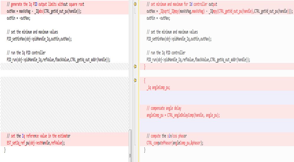

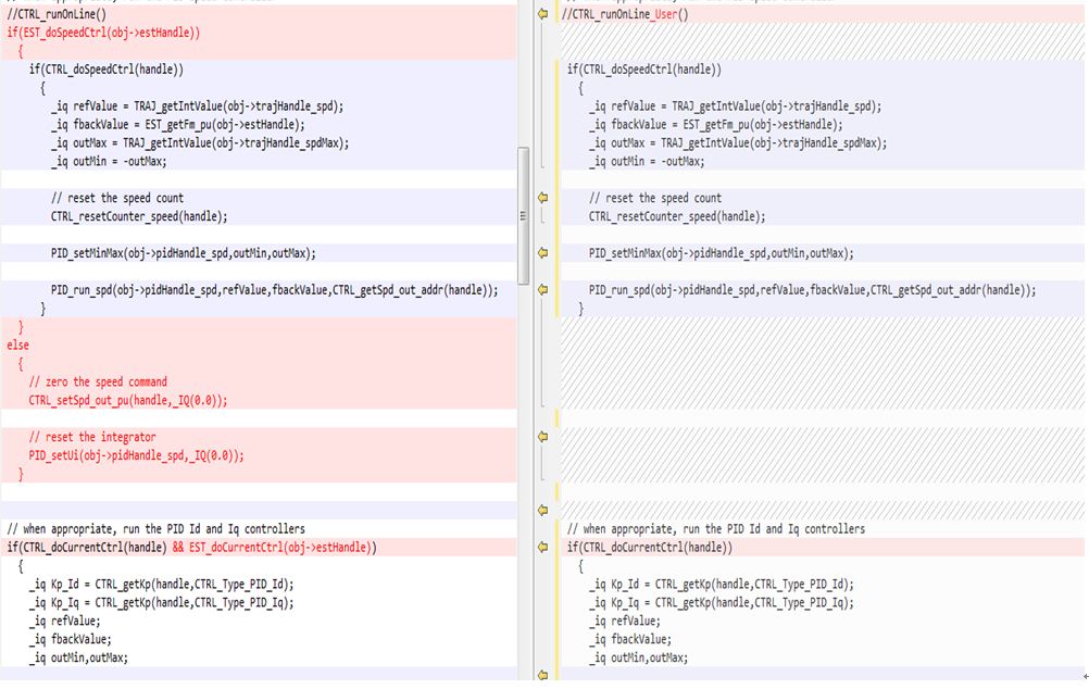

对比CTRL_runOnLine_User(handle,pAdcData,pPwmData)函数和CTRL_runOnLine_User(handle,pAdcData,pPwmData)函数并没有太大的区别,这是怎么实现的电机参数辨识算法?
3.FAST observer是FAST观测器 ,输出Flux、angle 、speed、torque.
估算器EST指的就是运行电机参数辨识的程序吗,
这两个是不同的,是吗?谢谢~
  • EST就是运行电机参数辨识。
  • 文档中写到:
    when the motor is being identified CTRL_runOnLine is executed from ROM. After the motor is identified, CTRL_runOnLine_User is run from user RAM. CTRL_runOnLine_User is an inlined function that is located in ctrl.h. It contains the entire FOC implementation with calls to the FAST observer for rotor flux angle values.
     电机未辨识,运行CTRL_runOnLine(handle,pAdcData,pPwmData);电机进行参数辨识的估算器算法在这里执行完成。
    电机识别完成,运行CTRL_runOnLine_User(handle,pAdcData,pPwmData);//调用FAST观测器的电角度实现完整的FOC控制
    这两个函数实现不同的功能,对比CTRL_runOnLine_User(handle,pAdcData,pPwmData)函数和CTRL_runOnLine_User(handle,pAdcData,pPwmData)函数并没有太大的区别,请详细分析下电机参数辨识在CTRL_runOnLine函数是如何实现的?估算器部分程序不开源具体是在哪里调用的,谢谢
    附上CTRL_runOnLine(handle,pAdcData,pPwmData)函数:

    // when appropriate, run the PID speed controller
    if(EST_doSpeedCtrl(obj->estHandle))
    if(CTRL_doSpeedCtrl(handle))
    _iq refValue = TRAJ_getIntValue(obj->trajHandle_spd);
    _iq fbackValue = EST_getFm_pu(obj->estHandle);
    _iq outMax = TRAJ_getIntValue(obj->trajHandle_spdMax);
    _iq outMin = -outMax;
    // reset the speed count
    CTRL_resetCounter_speed(handle);
    PID_setMinMax(obj->pidHandle_spd,outMin,outMax);
    PID_run_spd(obj->pidHandle_spd,refValue,fbackValue,CTRL_getSpd_out_addr(handle));
    else
    // zero the speed command
    CTRL_setSpd_out_pu(handle,_IQ(0.0));
    // reset the integrator
    PID_setUi(obj->pidHandle_spd,_IQ(0.0));
    // when appropriate, run the PID Id and Iq controllers
    if(CTRL_doCurrentCtrl(handle) && EST_doCurrentCtrl(obj->estHandle))

    附上CTRL_runOnLine_User(handle,pAdcData,pPwmData)函数:
    if(CTRL_doCurrentCtrl(handle))

    outMax = _IQsqrt(_IQmpy(maxVsMag,maxVsMag) - _IQmpy(CTRL_getVd_out_pu(handle),CTRL_getVd_out_pu(handle)));
    outMin = -outMax;
    // set the minimum and maximum values
    PID_setMinMax(obj->pidHandle_Iq,outMin,outMax);
    // run the Iq PID controller
    PID_run(obj->pidHandle_Iq,refValue,fbackValue,CTRL_getVq_out_addr(handle));
    _iq angleComp_pu;
    // compensate angle delay
    angleComp_pu = CTRL_angleDelayComp(handle, angle_pu);

  • CTRL_runOnLine函数是如何实现参数辨识的?谢谢~
  • 参数辨识部分的程序是固化在ROM里的 在程序中调用即可,具体的原理老外没有公开,只是提供了接口参数。另外你可以看一下motorware中相关的文档:

    我有看过User's Guide的chapter 6 他具体的参数辨识策略,我也都能明白。只是这两个函数完全实现不同的功能,但对比这两个函数没有发现太大的区别。
    有如下几处差别:
    1.TI有没有关于ROM中的算法和用户存储区代码的相关说明,和具体调用策略。谢谢~
