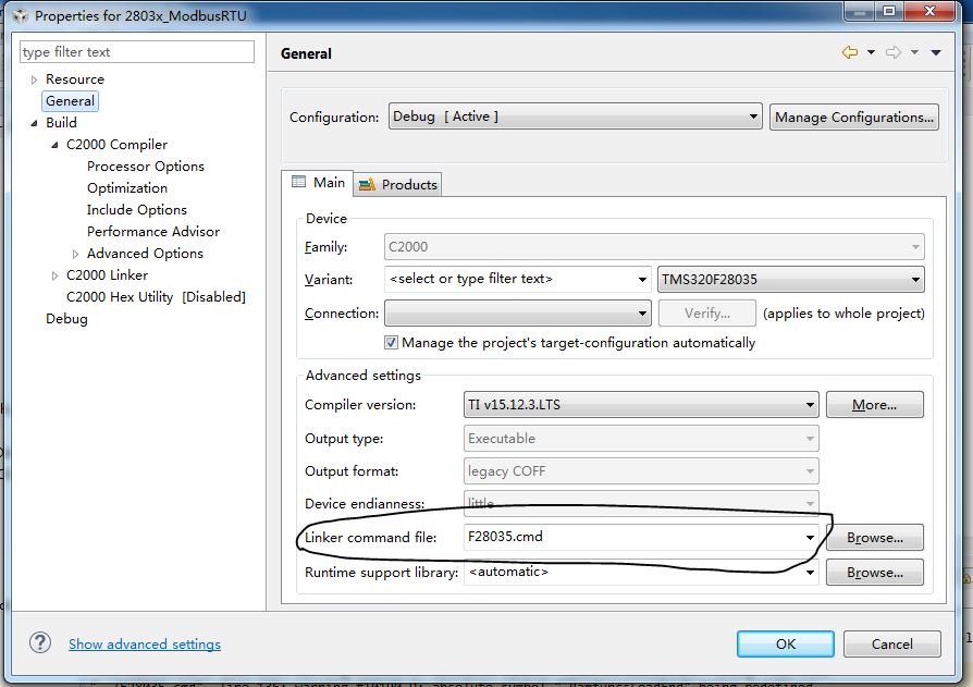

新建 的工程 选F28035.cmd编译出错,但是选28035_RAM_ink.cmd编译正常
软件:CCS6.2    安装在D盘。
新建的工程 选F28035.cmd编译出错,但是选28035_RAM_ink.cmd编译正常。我的程序里面就只有一个main.C,而且里面啥都没有写啊,更没有定义什么啊。这是什么原因,要怎么修改?
<Linking>
"../F28035.cmd", line 135: warning #10190-D: absolute symbol "_RamfuncsLoadStart" being redefined
"../F28035.cmd", line 136: warning #10190-D: absolute symbol "_RamfuncsLoadEnd" being redefined
"../F28035.cmd", line 137: warning #10190-D: absolute symbol "_RamfuncsRunStart" being redefined
"../F28035.cmd", line 135: warning #10272-D: section relative symbols from different output sections cannot be mixed; "_RamfuncsLoadStart" is in section "ramfuncs", "DOT operator" is in section ".TI.ramfunc"
"../F28035.cmd", line 136: warning #10272-D: section relative symbols from different output sections cannot be mixed; "_RamfuncsLoadEnd" is in section "ramfuncs", "DOT operator" is in section ".TI.ramfunc"
"../F28035.cmd", line 137: warning #10272-D: section relative symbols from different output sections cannot be mixed; "_RamfuncsRunStart" is in section "ramfuncs", "DOT operator" is in section ".TI.ramfunc"
'Finished building target: 2803x_ModbusRTU.out'
