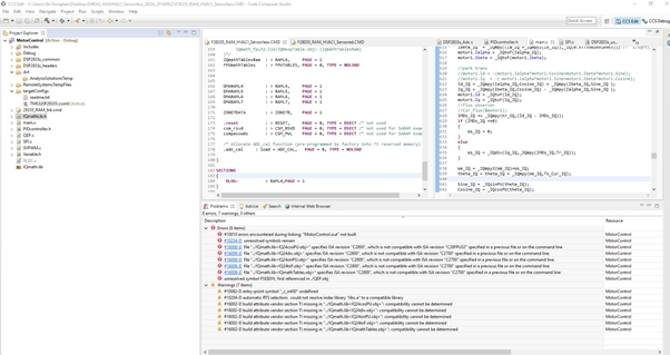

想使用TI 的IQ math加快系统计算速度,但是编译总不通过。
已经在主程序中include了 IQMATH.H;修改了CMD文件,并将IQMATH.LIB添加如工程中,但仍然报错。
具体的报错内容:
Description Resource Path Location Type
<a href="file:/C:/TI/ccsv6/tools/compiler/dmed/HTML/16008.html">#16008-D</a> file "../IQmath.lib<IQ24cosPU.obj>" specifies ISA revision "C2800", which is not compatible with ISA revision "C28FPU32" specified in a previous file or on the command line MotorControl C/C++ Problem;
<a href="file:/C:/TI/ccsv6/tools/compiler/dmed/HTML/16008.html">#16008-D</a> file "../IQmath.lib<IQ24div.obj>" specifies ISA revision "C2800", which is not compatible with ISA revision "C2700" specified in a previous file or on the command line MotorControl C/C++ Problem;
<a href="file:/C:/TI/ccsv6/tools/compiler/dmed/HTML/16008.html">#16008-D</a> file "../IQmath.lib<IQ24sinPU.obj>" specifies ISA revision "C2800", which is not compatible with ISA revision "C2700" specified in a previous file or on the command line MotorControl C/C++ Problem;
<a href="file:/C:/TI/ccsv6/tools/compiler/dmed/HTML/16008.html">#16008-D</a> file "../IQmath.lib<IQ24toF.obj>" specifies ISA revision "C2800", which is not compatible with ISA revision "C2700" specified in a previous file or on the command line MotorControl C/C++ Problem;
<a href="file:/C:/TI/ccsv6/tools/compiler/dmed/HTML/16008.html">#16008-D</a> file "../IQmath.lib<IQmathTables.obj>" specifies ISA revision "C2800", which is not compatible with ISA revision "C2700" specified in a previous file or on the command line MotorControl C/C++ Problem;
  • 从这几条报错信息上看,该错误应该是编译器环境配置的问题,可以重点关注芯片类型(C28x 或 C27x),以及是否允许FPU...等
    建议从controlSUIT中调用例程,在例程基础上加入你自己的东西,这样可以保留例程中对编译环境的配置,你也可以自行对比配置的差别,来找到原因。
  • 您好,把float support 设置成solidlib 以后编译后只有warning,没有error了。
  • 您好,这个float support 在哪呢?谢谢
