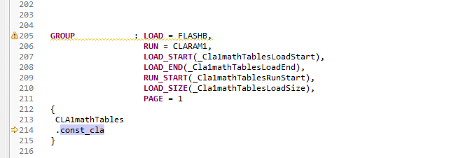

28069 CLA FLASH CMD 警告的问题: LOAD placement ignored for "GROUP_1": object is uninitialized
以下是小弟的CMD文件

/* Allocate sections to memory blocks.
Note:
codestart user defined section in DSP28_CodeStartBranch.asm used to redirect code
execution when booting to flash
ramfuncs user defined section to store functions that will be copied from Flash into RAM
SECTIONS

//cla
.bss_cla : > CLARAM0, PAGE = 1
.scratchpad : > CLARAM0, PAGE = 1
Cla1Prog : LOAD = FLASHD,
RUN = RAML1,
LOAD_START(_Cla1funcsLoadStart),
LOAD_END(_Cla1funcsLoadEnd),
RUN_START(_Cla1funcsRunStart),
LOAD_SIZE(_Cla1funcsLoadSize),
PAGE = 0//, ALIGN(4)
Cla1ToCpuMsgRAM : > CLA1_MSGRAMLOW, PAGE = 1
CpuToCla1MsgRAM : > CLA1_MSGRAMHIGH, PAGE = 1
Cla1DataRam0 : > CLARAM0, PAGE = 1
Cla1DataRam1 : > CLARAM1, PAGE = 1
Cla1DataRam2 : > CLARAM2, PAGE = 1
GROUP : LOAD = FLASHB,
RUN = CLARAM1,
LOAD_START(_Cla1mathTablesLoadStart),
LOAD_END(_Cla1mathTablesLoadEnd),
RUN_START(_Cla1mathTablesRunStart),
LOAD_SIZE(_Cla1mathTablesLoadSize),
PAGE = 1
CLA1mathTables
.const_cla
CLAscratch :
{ *.obj(CLAscratch)
. += CLA_SCRATCHPAD_SIZE;
*.obj(CLAscratch_end) } > CLARAM0,
PAGE = 1

求各位同行指导啊
需要的话,我把MAP文件也贴上来
