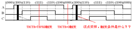

     我用电阻采样法重构相电流,需要在相量V(100)处触发ADC采样,这如何实现?datasheet中只有TBCTR=TBPRD和TBCTR=0两种触发方式。
  • 可以设定比较值触发。
    EPWMxSOCA Selection Options
    These bits determine when a EPWMxSOCA pulse will be generated.
    000 Enable DCAEVT1.soc event
    001 Enable event time-base counter equal to zero. (TBCTR = 0x0000)
    010 Enable event time-base counter equal to period (TBCTR = TBPRD)
    011 Enable event time-base counter equal to zero or period (TBCTR = 0x0000 or TBCTR =
    TBPRD). This mode is useful in up-down count mode.
    100 Enable event time-base counter equal to CMPA when the timer is incrementing.
    101 Enable event time-base counter equal to CMPA when the timer is decrementing.
    110 Enable event: time-base counter equal to CMPB when the timer is incrementing.
    111 Enable event: time-base counter equal to CMPB when the timer is decrementing.
