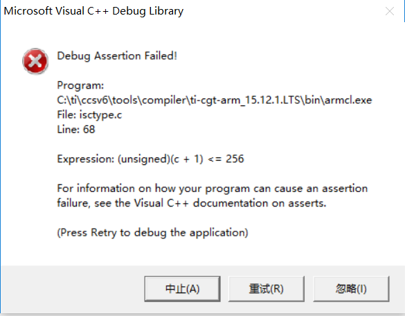

为什么我用6.13创建不了新工程
如图  附件
  • ccs的安装路径以及用户名不能有中文字符。
    A temporary directory using the Username is created during installation, and Eclipse is unable to handle non-ascii characters. If your Username does have non-ascii characters, please create a temporary admin user for installing CCS.
    http://processors.wiki.ti.com/index.php/Troubleshooting_CCSv7#Project_Management_and_Build
