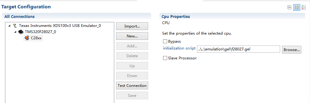

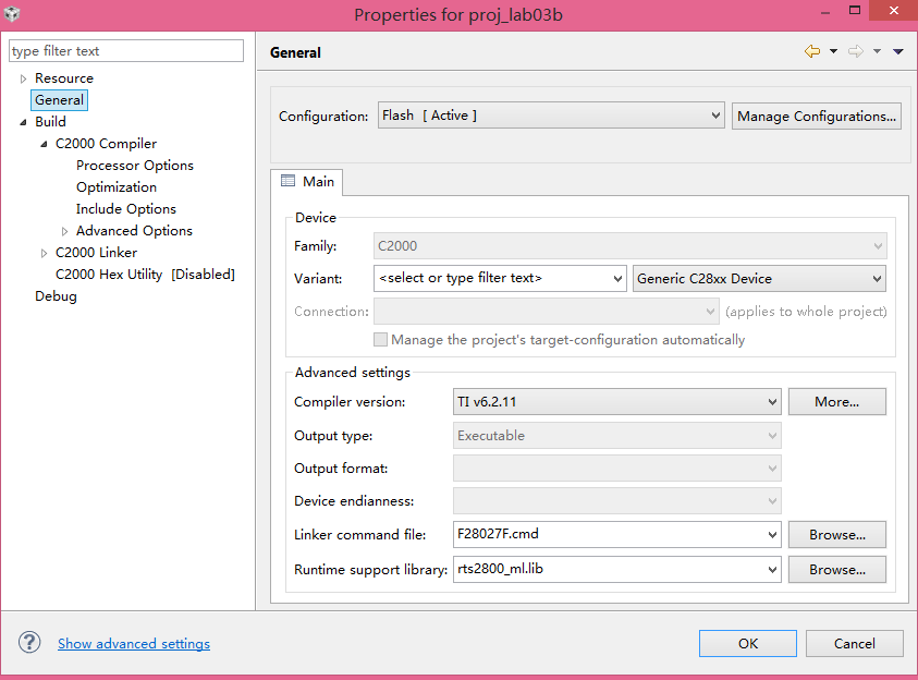

所用器件为TMS28027F    仿真器XDS100V3
问题描述:仿真器可以连接上,但是下载程序时提示如下信息
C28xx: Flash Programmer: Warning: The configured device (TMS320F28027), does not match the detected device (). Flash Programming operations could be affected. Please consider modifying your target configuration file.
C28xx: GEL Output:
Device Calibration not complete, check if device is unlocked and recalibrate.C28xx: Flash Programmer: Device is locked or not connected. Operation cancelled.
C28xx: GEL: File: G:\ti\motorware_1_01_00_16 - 3b\sw\solutions\instaspin_foc\boards\boostxldrv8301_revB\f28x\f2802xF\projects\ccs5\proj_lab03b\Flash\proj_lab03b.out: Load failed.
请问这是什么原因
