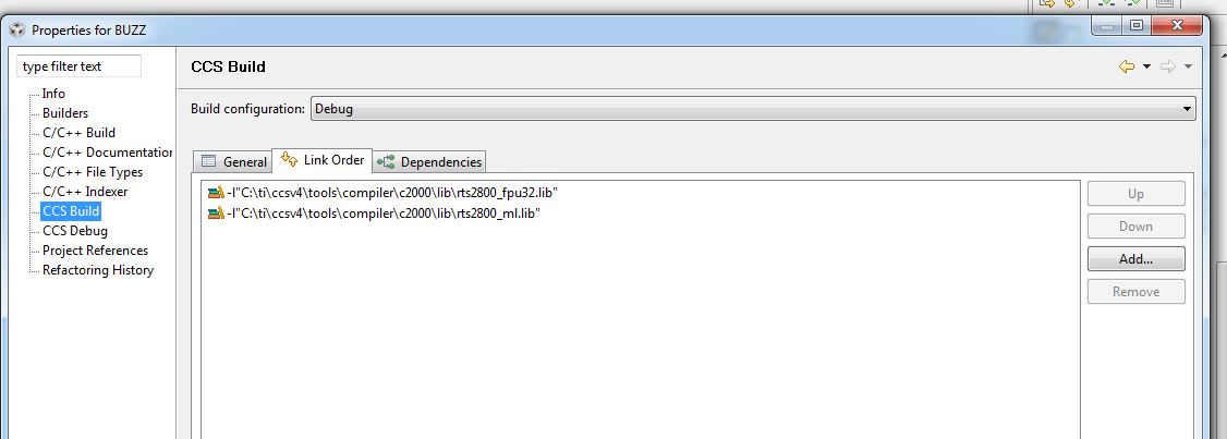

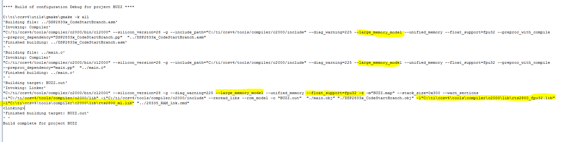

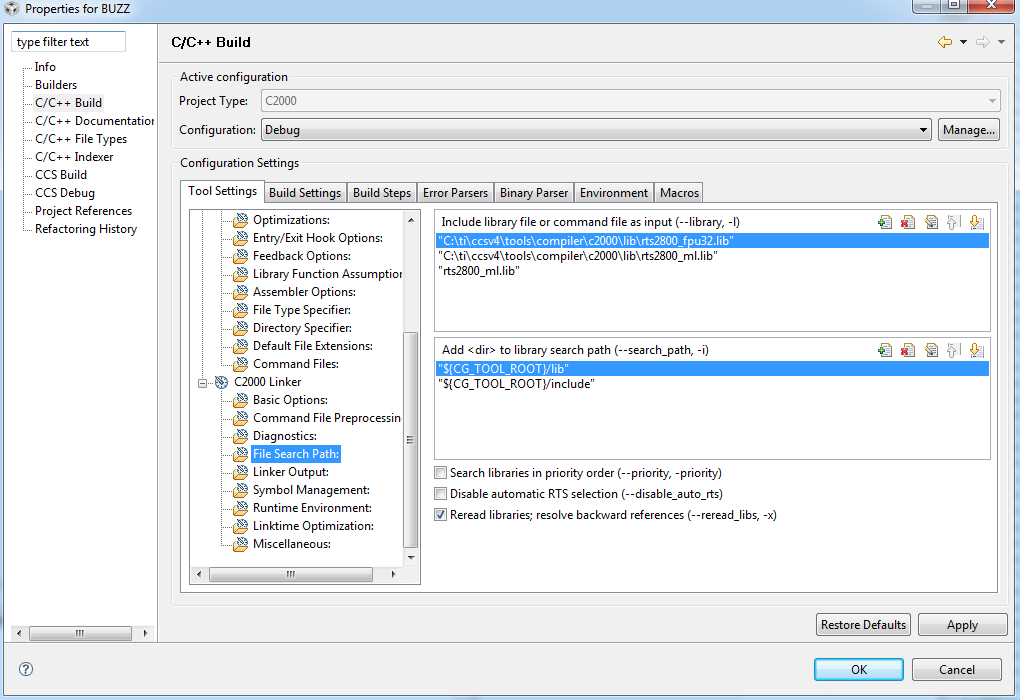

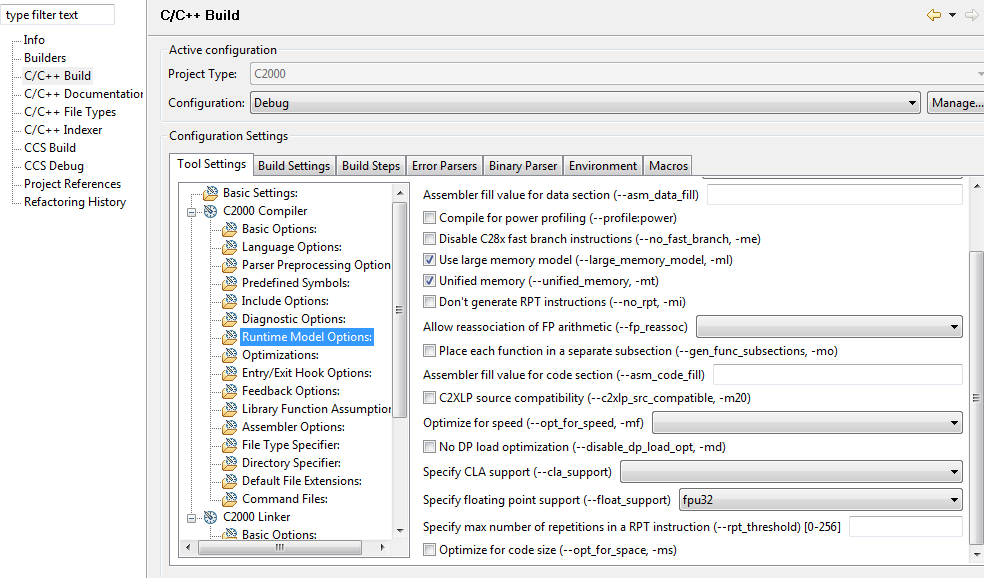

开发过程中需要调用flashAPI,文档上说需要设置浮点运算,如下图设置后发现程序编译没有问题,但烧到板子后程序跑死,寄存器CLASSID值看是E8也不是EF (TMS320F2833x Floating Point Class device).
哪位大侠帮忙分析下,急用

F28235是定点的,不支持FPU,所以程序中不需要使能FPU的。

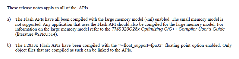

您看的这个是F28335的flash API文档,F28235的相关文档在以下目录下:
C:\ti\controlSUITE\libs\utilities\flash_api\2823x\28232\v210\doc
文档中有如下描述:
The F2823x Flash APIs have been compiled without using the “--float_support=fpu32” floating point option.
Only object files compiled as such can be linked to the APIs. Object files compiled for the F2833x devices must
be fixed point to use the F2823x Flash APIs. If floating point is required for these devices the appropriate
F2833x Flash API must be used.
