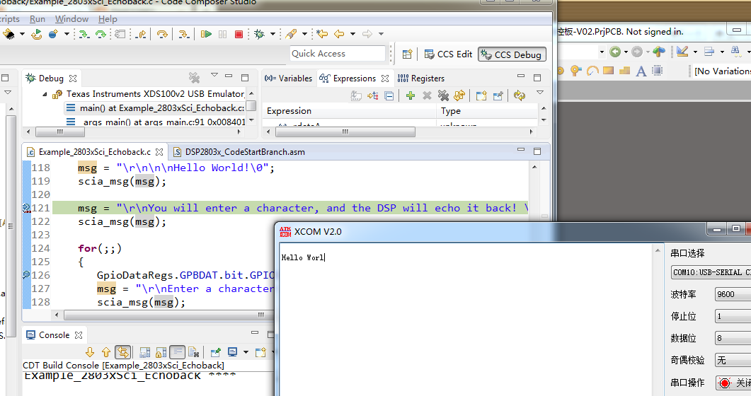

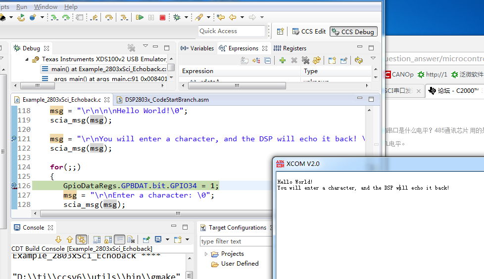

哪位能帮我看下sci通讯发送出来的数据是乱码,找了好久都不知道是哪里出错了。外部晶振20MHZ,波特率设置的是115200

void scia_echoback_init()
SciaRegs.SCICCR.all =0x0007; // 1 stop bit, No loopback
// No parity,8 char bits,
// async mode, idle-line protocol
SciaRegs.SCICTL1.all =0x0003; // enable TX, RX, internal SCICLK,
// Disable RX ERR, SLEEP, TXWAKE
SciaRegs.SCICTL2.bit.TXINTENA =1;
SciaRegs.SCICTL2.bit.RXBKINTENA =1;
SciaRegs.SCIHBAUD =0x0000; // 9600 baud @LSPCLK = 15MHz (60 MHz SYSCLK).
SciaRegs.SCILBAUD =0x000F;//0x0F(115200)
SciaRegs.SCICTL1.all =0x0023; // Relinquish SCI from Reset

void scia_xmit(int a)
// while (SciaRegs.SCIFFTX.bit.TXFFST != 0) {}
while (SciaRegs.SCICTL2.bit.TXEMPTY == 0) {}
SciaRegs.SCITXBUF=a;
void scia_msg(char * msg)
int i;
i = 0;
while(msg[i] != '\0')
scia_xmit(msg[i]);
i++;
