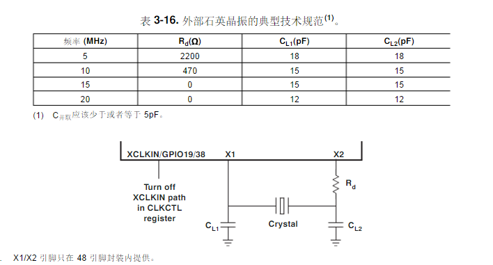

外部晶振无法使用
我是用的28027芯片,时钟配置如下:
CLK_disableOsc1(clkHandle);
CLK_setOscSrc(clkHandle,CLK_OscSrc_External);
CLK_disableClkIn(clkHandle);
CLK_enableCrystalOsc(clkHandle);
CLK_disableOsc2(clkHandle);
PLL_setup(pllHandle, PLL_Multiplier_6, PLL_DivideSelect_ClkIn_by_2);
PLL_setup函数如下:
void PLL_setup(PLL_Handle pllHandle, const PLL_Multiplier_e clkMult, const PLL_DivideSelect_e divSelect)
    if(PLL_getClkStatus(pllHandle) == PLL_ClkStatus_Missing)
        // The clock is missing so we cannot setup the PLL correctly
        asm(" ESTOP0");
    // Set divider to max value (/4) for safety
    PLL_setDivider(pllHandle, PLL_DivideSelect_ClkIn_by_4);
    // Set the desired multiplier
    PLL_setMultiplier(pllHandle, clkMult);
    while(PLL_getLockStatus(pllHandle) != PLL_LockStatus_Done)
    // Set the desired divider
    PLL_setDivider(pllHandle, divSelect);
} // end of PLL_setup() function
使用外部20M晶振,按照手册配置的外部电路;编译通过,但是烧写程序时,烧写进去了,但是仿真开始,就会执行到下面的语句,仿真停止
        asm(" ESTOP0");
然后软件重新配置使用内部晶振,但是程序怎么也烧不进板子,一直报下面的错误,怎么都不行了,求大神指点,怎么配置外部晶振?如何退出下面这个模式?急,在线等!!!
