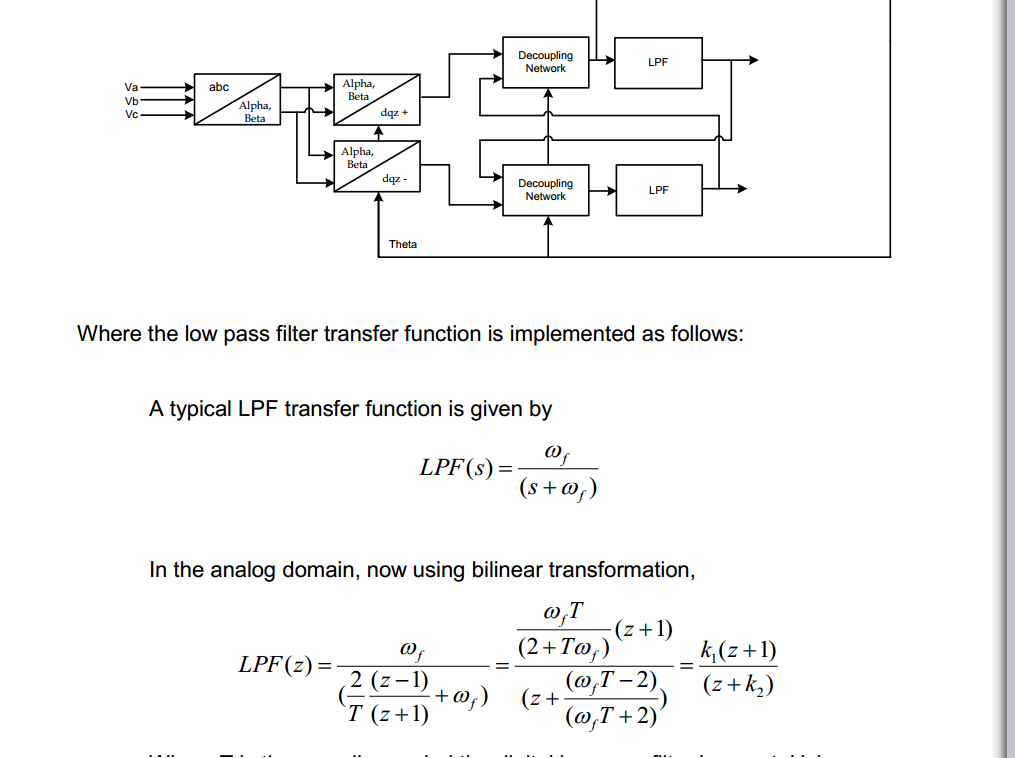

程序中对应的离散方程
// Low pass filter //
spll_obj->y[1] = (spll_obj->d_p_decoupl*spll_obj->k1) - (spll_obj->y[0]*spll_obj->k2);
spll_obj->d_p_decoupl_lpf = spll_obj->y[1] + spll_obj->y[0];
spll_obj->y[0] = spll_obj->y[1];
程序中对应的离散方程
28335,例程在C:\TI\controlSUITE\libs\app_libs\solar\v1.2\float\source\SPLL_3ph_DDSRF_F
看下这边wiki链接:
https://en.wikipedia.org/wiki/Low-pass_filter
