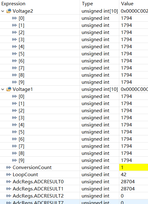

新手提问!28335ADC模块转换时,为什么结果寄存器的值没有变化?求大神帮帮忙看看。困扰我1个星期了!

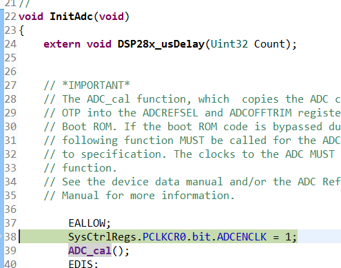

InitAdc(); // For this example, init the ADC

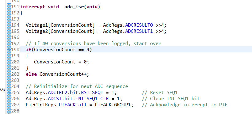

interrupt void adc_isr(void)
Voltage1[ConversionCount] = AdcRegs.ADCRESULT0 >>4;
Voltage2[ConversionCount] = AdcRegs.ADCRESULT1 >>4;
// If 40 conversions have been logged, start over
if(ConversionCount == 9)
ConversionCount = 0;
else ConversionCount++;
// Reinitialize for next ADC sequence
AdcRegs.ADCTRL2.bit.RST_SEQ1 = 1; // Reset SEQ1
AdcRegs.ADCST.bit.INT_SEQ1_CLR = 1; // Clear INT SEQ1 bit
PieCtrlRegs.PIEACK.all = PIEACK_GROUP1; // Acknowledge interrupt to PIE
return;
参照ADC_soc实例程序改的。我可以正常进入中断程序,但是ADCRESULT0和ADCRESULT1的值总是没有变化。
求大神帮帮忙看看。困扰我1个星期了!
