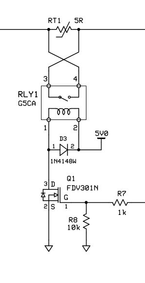

想请问,如果将BLPFC的inrush Relay电路拆除,电路是否能够正常运作,如不行将会发生什么情形?
本人电路板毁损,故只能在这请教各位,谢谢。
Yes, you can. But if you don't have any inrush current limit then you will have to slowly increase the AC input voltage while powering up the PFC.
