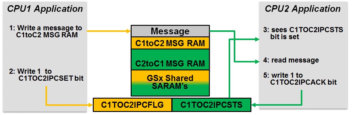

  • 可以参考下面的例子自己做一个架构
    Basic option – no software drivers needed and easy to use!
    Use the message SARAM’s and global shared SARAM’s (GSx blocks) to pass data between processors at a known address
    Use the IPC flag registers to tell the other processor that the data is ready
  • 我这边是通过IPC中断,在GS0~GS15中交互数据,事先划分好控制权,比如CPU1写给CPU2的就在GS0里,CPU2返回CPU1的就在GS1里这样
